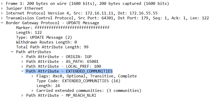

on the customer side we created a prefix that matches the loopback address. when exactly does it match? is it only when the customer advertise the 10.10.10.10 it will send the community with it?
Hello Muayad
That’s an excellent question. One thing we have to remember when talking about communities is that a community is a BGP attribute. It’s not involved in the BGP best path algorithm, but it is an attribute in the sense that it is included in the BGP update as part of that prefix. If you look at a Wireshark capture of a BGP update sending a prefix that has an associated community, you can see it in the list of Path Attributes like so:
So, if you have configured the Customer router to attach a particular community to a prefix (using a route map, for example), then that router will always advertise that prefix with the associated community.
Now to understand the use of the word “match” in this context, the more general idea here is that if you want to treat a particular group of prefixes in a specific way, one way is to make them all belong to a particular community. It’s kind of like a tag. You can then place route maps in an incoming direction on your BGP peers, and match the community in question, and apply the policy you want. So the matching takes place after the communities have already been assigned and are being advertised.
As you can see in section 1.2 of the lesson, the ISP router has an incoming route map that matches the specific community, and acts upon it in some way. In this case, it applies AS Path Prepending.
Now matching is also used when applying the community, but this is done to match the specific prefix in question. On the customer router as shown in section 1.3, there is a route map that matches the prefix, and applies the community to that prefix, so when the BGP update is sent out of that interface, the community attribute is applied.
