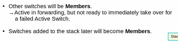

A quick question, what is the difference between a standby and a member switch in terms of state and configuration? I know that the standby switch can take over the active switch’s role but apart from that, does its configuration or state differ in any way in comparison with a member switch? Theoretically, could a member switch also take over the active role without any issues?
My other resource says
obrĂĄzok
Why aren’t they ready to immediately take over?
A standby switch is one that is in a “hot-standby state”. This means that it has full synchronization of the running configuration, control plane protocols (OSPF, EIGRP etc) and MAC/ARP tables. As the active switch updates these constructs in its normal operation, the standby switch gains real-time updates on all of these, so that in the event of a failure of the active switch, the standby switch can assume the role without any service interruption.
Member switches don’t have this live update of synchronized structures. Member switches only have a synchronized copy of the running configuration.
Now having said that, when the active switch fails and the standby switch takes over as the new active, the stack automatically promotes one of the remaining member switches to become the new standby switch.
In order for a member switch to have to immediately take over as active switch, both the current active and standby switches must fail at the same time. If that happens, there will be a temporary loss of the control plane, so there will be an outage. The remaining member switches would initiate a stack master election, and the newly elected active and standby switches would have to rebuild the control plane constructs in order to get back to full operation. So no, a member switch could not take over without any disruption. It would eventually take over but with a substantial network interruption. Does that make sense?
