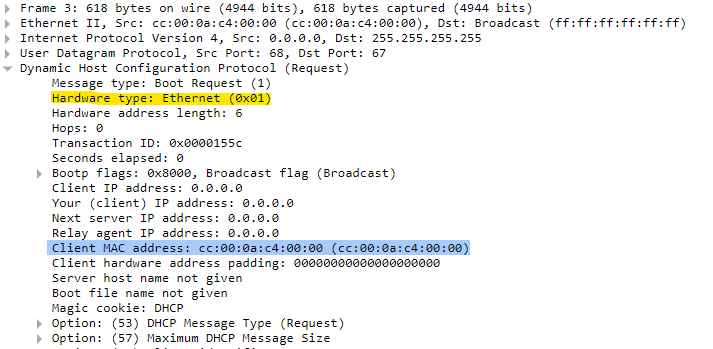

The MAC address is actually 0152.5400.0b34.75. Laz, you’ve mentioned that DHCP adds an extra 01 to the MAC address? Any idea why does it work like this? :smiley: So I suppose that the best would just be to copy whatever identifier is being used off the debug output.

First of all, the above requires that you have configured the client to use the MAC address as the client identifier by issuing the ip address dhcp client-id <interface> command. Once that’s done, the MAC address will be used as the client identifier. Now, doing a bit more research, I have found that the “01” that is prepended on the client ID is actually a hardware identifier. It denotes that the following information is an Ethernet MAC address. For some reason, the Cisco debug chooses to display the hardware identifier as part of the client ID. This can be understood as an attempt to ensure the uniqueness of the client identifier in the event that there are technologies being used other than Ethernet (such as FrameRelay, FiberChannel, or ATM to name a few). If you look at a packet capture of a DHCP request, you can see that identifier like so (yellow highlight):
Knowing this, you can identify the exact MAC address by simply removing that 01 prefix from the rest of the client ID.
