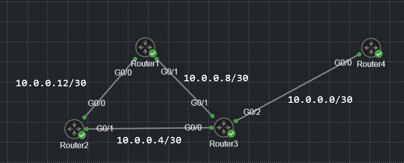

Hello!
I have a quick question about the EIGRP Split Horizon rule.
So Rene mentioned in the previous lessons that the rule states “never advertise a route out the interface you’ve just learned it on”
I have this topology here.
If I shutdown the link between R2 and R3, it won’t learn about the destination (10.0.0.0/30) from it, so it will only receive the EIGRP UPDATE packet from R1.
However, if I then decide to enable that link on R2, it will receive the UPDATE packet from R3 and then also advertise it to R1.
But doesn’t the rule say not to advertise a route out the interface it was learned on?
In your example, the split horizon rule is not being violated. When you reenable the link between R1 and R2, R1 will receive an UPDATE from R3 about 10.0.0.0/30, and it will resend it to R1. Note that this UPDATE containing the network 10.0.0.0/30 was received from R3 (via G0/1) and sent out of G0/0 to R1. So the split horizon rule was not violated.
So the difference is that in this case, R2 is saying to R1 with its update: “You can reach the 10.0.0.0/30 network through me because I have a route to that destination via R3.”
If the split horizon rule was violated, R2 would be saying the following to R1 with its update: “You can reach the 10.0.0.0/30 network through me because I have a route to that destination via R1.”
You can immediately see that the second case would cause a problem because if the link between R1 and R3 failed, R1 would try to reach the 10.0.0.0/30 network through R2, and R2 would try to reach the 10.0.0.0/30 network through R1, thus resulting in a ping-pong match between the two routers.
The first case would be valid, because in the event of the same failure, R1 would try to reach 10.0.0.0/30 via R2, and R2 in turn will try to reach it via R3, thus avoiding the pingpong match.
Now I believe that your concern here is that even if the split horizon rule wasn’t violated, R1 is still learning about the 10.0.0.0/30 network from two different sources. Doesn’t that cause a loop even if the split horizon rule is not violated? Well, no because the metrics take care of that. R1 will not choose to reach the 10.0.0.0/30 network via R2 because it is not the shortest path. Similarly, R2 will not reach the network via R1, because it’s not the shortest path. Does that make sense?
