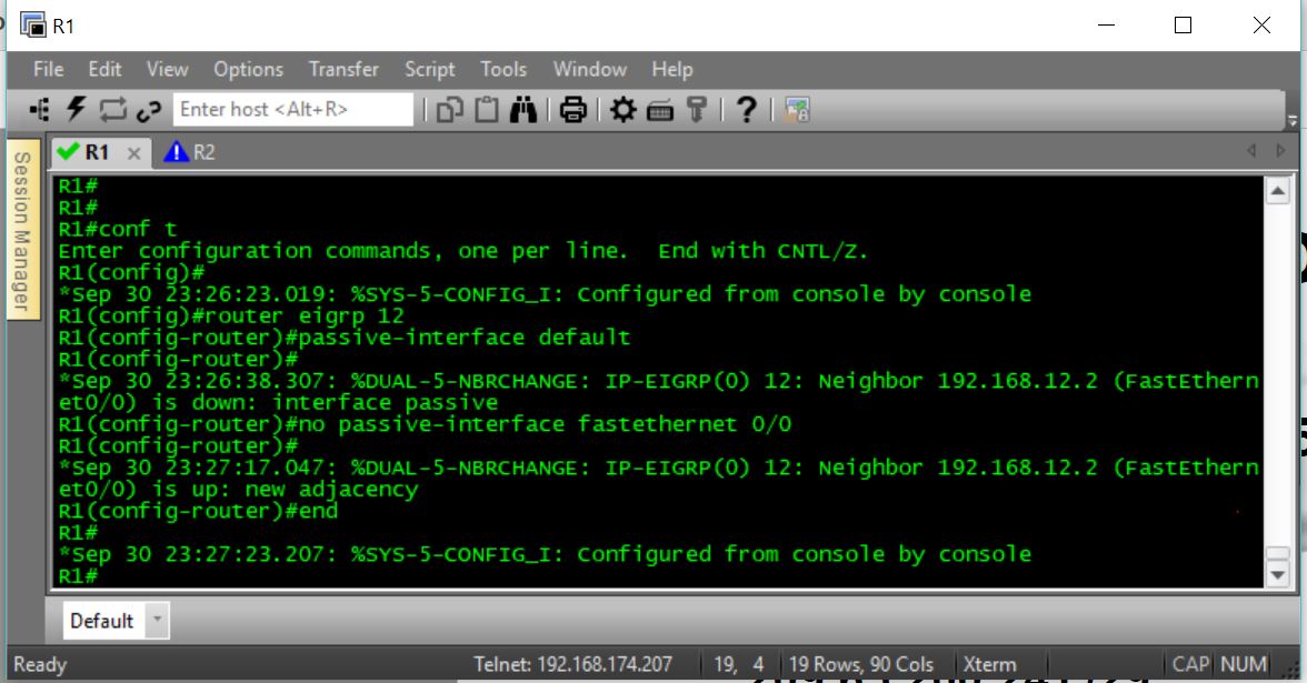

Hi Adil,
The adjacency will be killed. If you use passive-interface on all interfaces then you need to use no passive-interface for the interfaces that require an EIGRP neighbor adjacency.

Great and easy to understand lesson. I would only make one request on this for something to be added.
in my lab of this lesson everything went smoothly. Only thing I had some hiccups on that I had to search was the following.
I knew how to setup from the lesson the default command for passive interface. However, for some reason I was thinking “incorrectly” that I needed to setup the no passive-interface command under the interfaces… I tried a few times but it was not working for obvious reasons as that was the wrong place. Its small thing and I quickly did a search and found out what I was doing wrong. However, that would be nice to specify that went under the Eigrp router command.

Hello Brian
In EIGRP just like in OSPF, it is possible to set the default state of an interface as passive with the passive-interface default
command under the router eigrp
configuration. This is explicitly explained in the OSPF passive interface lesson found below, but not in the EIGRP passive interface lesson.
I will inform Rene about your suggestion to add it explicitly in this lesson as well.
