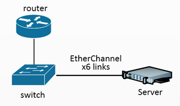

  1. According a topology below a single server is connected via EtherChannel to a single Layer 2 switch. A router is the default gateway to the server. I think in this case on the switch traffic flow from the router should be load balanced based on the destination addresses (MAC or IP). Let me know please if I’m wrong.
