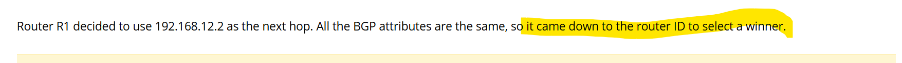

The lowest RID was chosen as the tiebreaker, according to the notes from this lesson.
Also, I did some testing and found that it’s not preemptive when I re-bounce the R1-R2 peer to check the path selection for 2.2.2.2/24 loopback IP in AS-2. It chose the next available path via R3 as the best path for 2.2.2.2/24. Even after the BGP peer came up b/w R1-R2, it still chose the best path via R3. Please confirm whether this is BGP’s actual behavior.
Hello Sathish
BGP is not preemptive in nature. It will only reevaluate a best path if a new BGP update is received or if there is a topology change on a local interface. There are no periodic updates between BGP peers like there are in some other routing protocols.
R1 will choose R2 as the best path to the 2.2.2.0/24 network using the lowest router ID attribute only if an event triggers R2 to send a BGP update with this information. R1 will not know of R2’s lower router ID unless it receives an update.
Now you are seeing that if you bounce the R1-R2 peering, it still chooses the path via R2. How you bounce the peering will affect whether or not R2 will resend a BGP update. How are you bouncing your peering?
Also, if you issue the clear ip bgp command on R2, it will force all its peerings to reset, resulting in sending an update. If after that you get the expected result of the path via R2, all is well. If not, then it is likely that there is another attribute before the router ID that is causing R3 to be chosen over R2. Let us know what you come up with in your troubleshooting.
