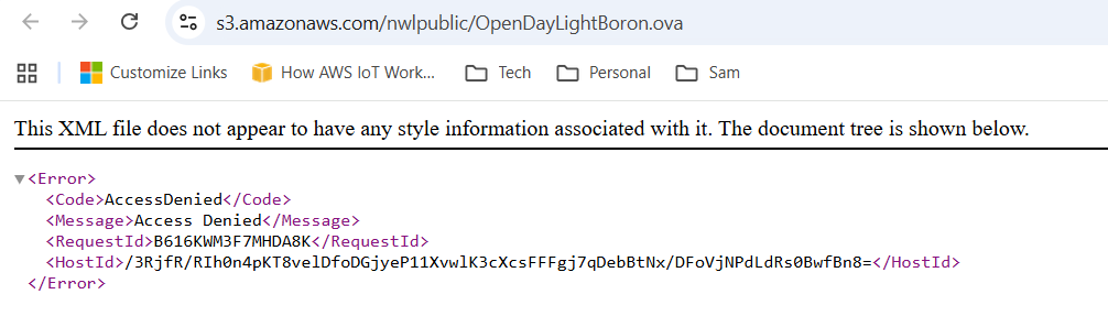

Hi Team,
Iam unable to access the VM through the link provided. Could you please help with this.
https://s3.amazonaws.com/nwlpublic/OpenDayLightBoron.ova
Iam getting this following error:
Hello Sruthi
Thanks for the heads up!! I will let @ReneMolenaar know to take a look and fix it.
