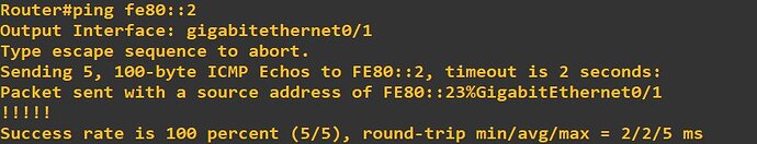

I do a little GNS3 lab to make some basic test
I turn on telnet on R3
and want to telnet from R2 to R3 using link-local address
Ping is OK
But telnet fails
I dont understand why R2 should have a routing table (L3) to telnet to R3 on link-local ?

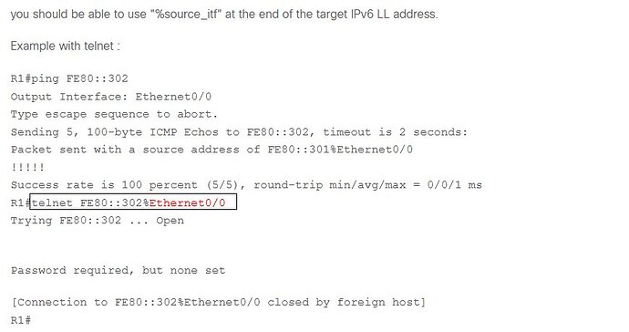

I google on a forum and find a reply from a cisco employee
So what is wrong on my basic lab ?

Hello Dominique
This is an interesting question. I have gone in and labbed it up and it seems that I get the same results as you. However, if I attempt to issue the telnet command with the link local address of the other router, and I don’t include the exit interface, it works:

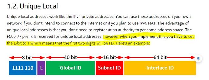

Hello Liz Sir,
I have two question in IPV6 unique local Address.
  1. In unique local IPV6 address, I didn’t understand the term of (FD) that what does it mean
  2. What is the purpose of L-bit?
    Please see the output I have highlighted by yellow colors those explanation which I didn’t understand.

Hello Ajmal
In the lesson, it states that a unique local address uses the FC00::/7 address space. In binary, the first seven bits of that address become: 1111 110. However, as stated in the lesson, the L bit must be set to 1 when you use it. The L bit is the 8th bit in the IPv6 address. That means that all Unique local addresses will begin with the binary sequence 1111 1101 where the 8th bit (L bit) is set to 1. That means that in hexadecimal, that will become FD (F=1111 and D=1101).
Now the L bit is used to indicate that the address should be used privately, similar to IPv4 private addresses. When this is set to 1, it indicates that the address is locally assigned, and should not be routable on the Internet. RFC 4193 states that these addresses should be used inside a private organization. In essence, this was done in order to keep the rest of the addresses (where the L bit is set to 0) available for future use.
