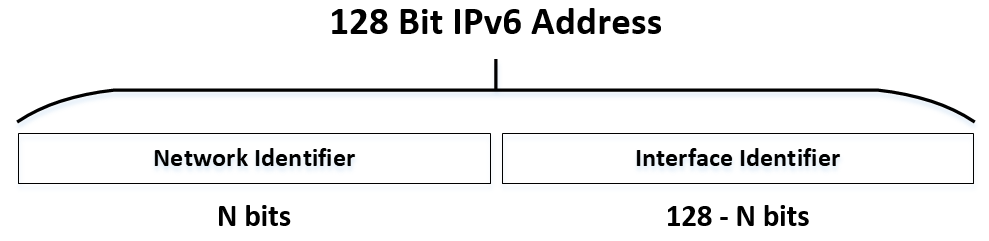

On the other hand, an interface identifier within the context of IPv6 is actually a component of the IPv6 address. In the same way that an IPv4 address is separated into its network and host portions, their counterparts in IPv6 are the network identifier and the interface identifier. Take a look at this image:
N is the prefix for that particular IPv6 address. So, if we had a /64 prefix, then the network identifier is defined as the first 64 bits of that address, and the interface identifier is defined as the last (128-64) = 64 bits of the address.
If we had a prefix of /96, then the first 96 bits are the network identifier, and the last 32 are the interface identifier.
In the context of EUI-64, this process is used to automatically assign an interface identifier based on the datalink layer address. In the case of Ethernet, thatâs the use of the MAC address.
