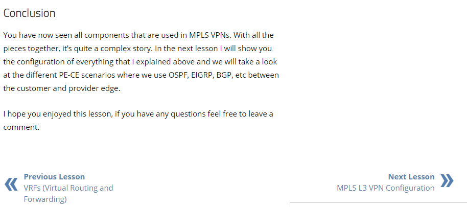

The Conclusion says “In the next lesson I will show you the configuration of everything that I explained above
”. The next lesson I see is “DMVPN”.
Hello Maodo.
The next lesson I see in the series is MPLS L3 VPN Configuration.
See the bottom right of the screenshot below:
If you see something different, let us know and we can look further into the problem.

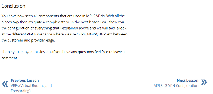

I send you the printscreen of what I see at the bottom of the page displayed by the link :slight_smile:https://networklessons.com/cisco/ccnp-route/mpls-layer-3-vpn-explained/![MPLS_NetworkLessons|690x200](upload://f5pVzqKT420RtlYIvdDXG40g3zN.png)
Hello Maodo
Hmmm, that is strange. I’ll get @ReneMolenaar to take a look
@kayoutoure @lagapidis
Depending on the course category, you get to see a different menu. For example:
This is the same lesson but it belongs to both the “mpls” and “ccnp route” category. Depending on the category, you get a different menu. It is a bit confusing that the one in CCNP route says “in the next lesson
” and then it jumps to DMVPN so I changed the wording in the conclusion a bit. I didn’t add those extra MPLS VPN lessons in CCNP route since there isn’t much MPLS on the CCNP ROUTE blueprint. This is something I’ll keep an eye on in the future :smile:
