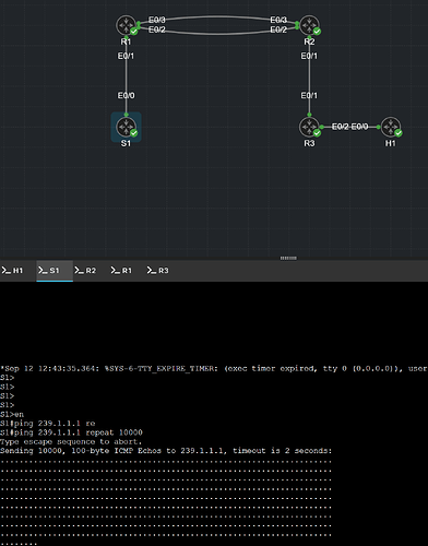

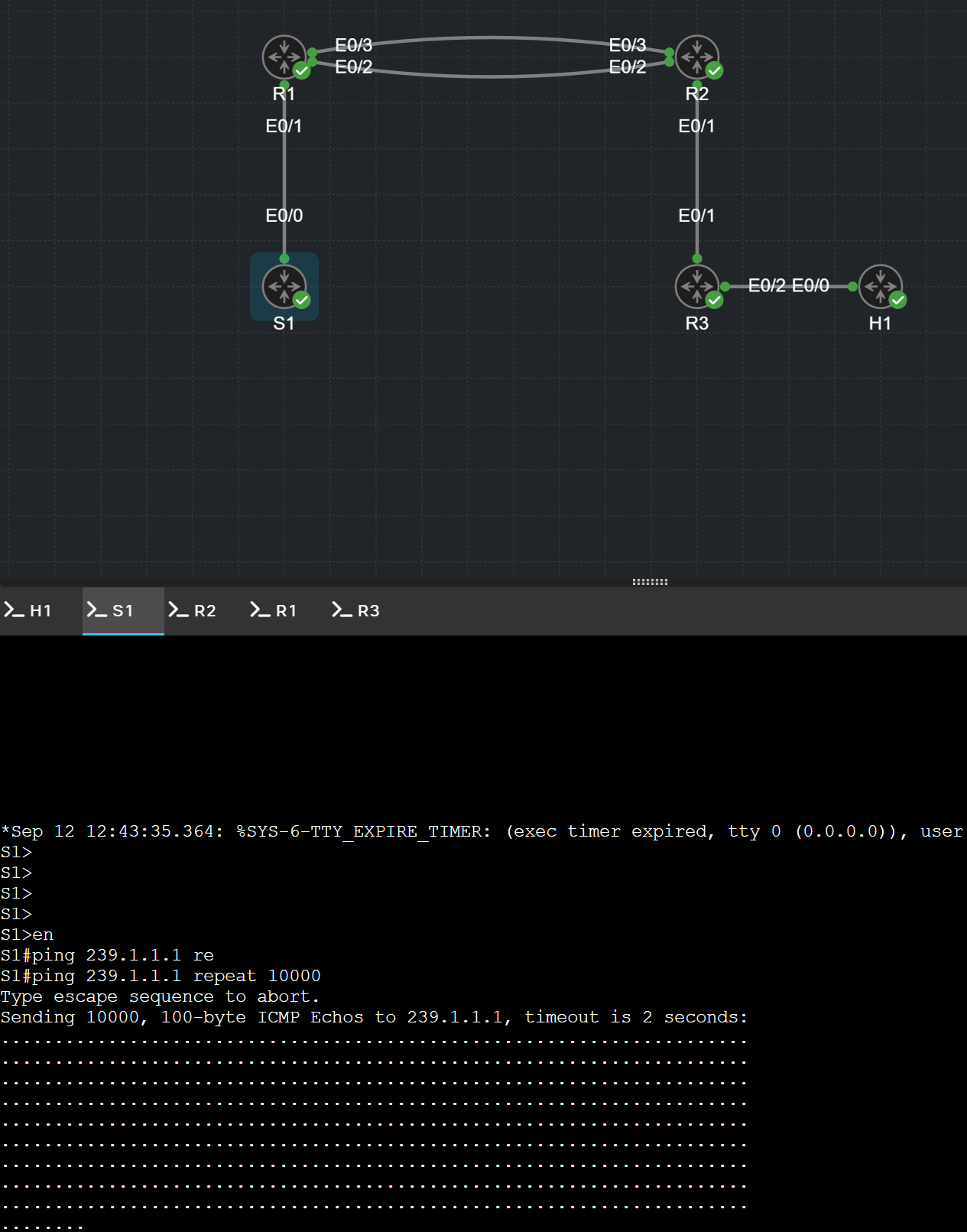

everything is ok, except last S1#ping 239.1.1.1 repeat 10000, can not get reply

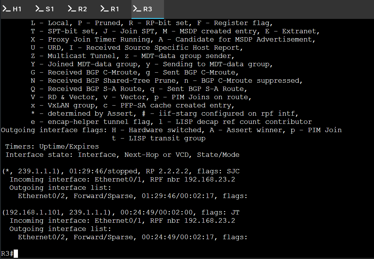

and R3 have multicat routes:
Hello Wilson
Taking a look at the mroute table of R1, it indicates that the 239.1.1.1 network has been added to the routing table correctly. This is expected, since your pings reached R1 and the entry was added. However, since your ping is failing, we must conclude that the problem exists at R2 and R3. I suggest you go through the lesson again and check out your configs compared to the final configs at the end of the lesson. If you’re still having trouble, share with us some of the multicast configs you have entered in the routers as well (not the whole configs, but only those pertaining to the lesson).
