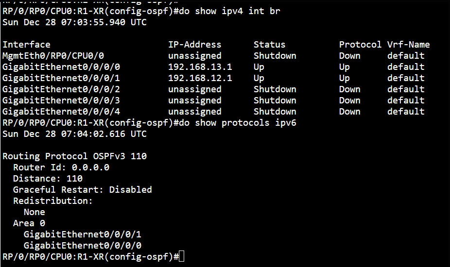

Is what I am seeing here correct? Shouldn’t the process be able to pick the RID? I have two interfaces with IPv4 configured. Because it picks it on IOS-XE and I haven’t found a documentation saying that XR doesn’t do this.
All I know from documentation is that XR actually prefers the lowest IP address but not that it would not pick anything at all with OSPFv3.
Hmm, that’s interesting. I haven’t found any documentation indicating that IOS-XR uses a “manual only” configuration of the router ID for OSPF. Indeed, I have found documentation stating that the classic process of highest loopback, and highest IPv4 address on an active physical interface still operates.
However, one small difference we find between XE and XR in some documentation (page 77) is that for IOS/IOS-XE, the router ID selection considers the device’s interfaces globally while IOS-XR router ID selection is said to be derived from IPv4 on interfaces “over which this OSPF process is running.”
I’m not sure if this is the reason you are facing this. Documentation aside, the idea that you should manually configure the router ID rather than have it automatically derived fits very well with the philosophy of the XR series of IOS devices and platforms. The idea is that an automatically derived router ID can introduce instability, especially if the interface from which the router ID has been derived fails. If this happens, OSPF needs to reconverge, which can be devastating for a high-capacity, high-demand provider network.
Just out of curiosity, what platform and IOS-XR version are you using? I could be something that is platform/version specific.
