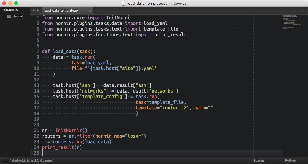

Would you mind adding topic to teach nornir framework in the course ? it seems getting popular day by day as a Framework the way it helps to manage larger inventory for hyperscale automation.
Hello Ripal
Thanks for your suggestion! It would be a good idea to share your suggestion on the following Member Ideas page.
There you will find that others may have suggested something similar, and you can add your voice to theirs. IN the meantime, take a look at this Cisco information about nornir:
