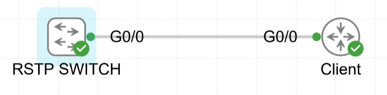

Whenever you have an RSTP-enabled switch connected to a client, a classic STP switch, or just anything that doesn’t run RSTP (therefore it cannot complete the Proposal-Agreement synchronization mechanism, the switch will operate that port under Classic STP rules. So it will spend 15 seconds in the Discarding state and 15 seconds in the Learning state before transitioning to forwarding.
RSTP(config)#spanning-tree mode rapid-pvst
RSTP(config)#interface G0/0
RSTP(config-if)#switchport trunk encapsulation dot1q
RSTP(config-if)#switchport mode trunk
RSTP(config)#do debug spanning-tree events
Spanning Tree event debugging is on
RSTP(config-if)#no shutdown
*Aug 21 11:51:51.664: %LINK-3-UPDOWN: Interface GigabitEthernet0/0, changed state to up
*Aug 21 11:51:52.664: %LINEPROTO-5-UPDOWN: Line protocol on Interface GigabitEthernet0/0, changed state to up
Aug 21 11:51:52.821: RSTP(1): initializing port Gi0/0
*Aug 21 11:51:52.825: RSTP(1): transmitting a proposal on Gi0/0
*Aug 21 11:51:53.351: RSTP(1): transmitting a proposal on Gi0/0
.... after a while
*Aug 21 11:52:07.822: RSTP(1): Gi0/0 fdwhile Expired - 15 seconds have passed
*Aug 21 11:52:19.413: RSTP(1): transmitting a proposal on Gi0/0
*Aug 21 11:52:21.417: RSTP(1): transmitting a proposal on Gi0/0
*Aug 21 11:52:22.823: RSTP(1): Gi0/0 fdwhile Expired - 30 seconds have passed
*Aug 21 11:52:22.824: STP[1]: Generating TC trap for port GigabitEthernet0/0
THE PORT IS FORWARDING
Notice how the port, upon being enabled, starts the synchronization process which never finishes because the client isn’t running RSTP. So 15 seconds pass, another 15 seconds pass, and then the port starts forwarding which are basically classic STP’s rules. Although the debug output is a little unclear when it comes to that, so I’ve marked the important points for you.
The solution? When you connect to a client, enable PortFast so the port can instantly transition into forwarding.
RSTP(config-if)#spanning-tree portfast trunk
*Aug 21 11:55:07.159: %LINK-3-UPDOWN: Interface GigabitEthernet0/0, changed state to up
*Aug 21 11:55:08.159: %LINEPROTO-5-UPDOWN: Line protocol on Interface GigabitEthernet0/0, changed state to up
*Aug 21 11:55:08.316: RSTP(1): initializing port Gi0/0
*Aug 21 11:55:08.316: RSTP(1): Gi0/0 is now designated
THE PORT IS INSTANTLY FORWARDING
