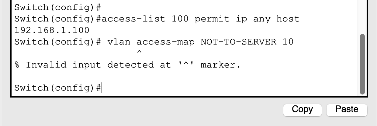

Hi, I’m using Packet Tracer 9.0.0.
With regards to the troubleshooting section no 3, I try to simulate the VLAN ACL from this lesson - https://networklessons.com/switching/vlan-access-list-vacl , I keep getting this error from the screenshot.
Can anyone advise if the switches on Packet Tracer support VLAN ACL?
Hello Kader.
Unfortunately, Packet Tracer doesn’t support most of the features that go outside the CCNA curriculum so for any more “advanced” features, you should try a virtual emulator like Cisco CML or physical hardware.

Hello Kader
@davidilles is correct, unfortunately Packet Tracer doesn’t support this particular command. This has to do with the nature of Packet Tracer compared to other products.
Packet Tracer is a network simulator, not an emulator. This means that it does not run actual Cisco IOS code. Instead, it is programmed to respond to commands in the same way as Cisco IOS. In this sense, it simulates network device behavior. But it does so only for a limited subset of commands and features, typically those needed for fundamental CCNA-level content. Advanced hardware-dependent features, such as VACLs (specifically the vlan access-map and vlan filter commands), are not implemented in Packet Tracer, even in the latest version.
GNS3, CML, and EVE-NG are emulators. They run actual Cisco IOS/IOS-XE images that are used on real hardware, so they contain all of the same features and capabilities as their real-equipment counterparts.
Packet Tracer should be enough if you’re focusing primarily on CCNA, but for anything more advanced, it’s worth it to invest the time (and in some cases money) to obtain an emulator.
