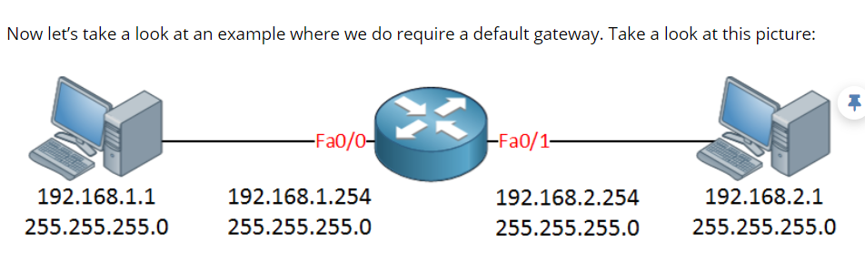

Hi Renee,
Iâm stuck in this lab for one week, I tried to solve the problem by myself but I failed to find a solution.
I have the same config as in the âdefault gateway courseâ (itâs a physical lab)
HOST 1 : 192.168.1.1
R1(1841 ROUTER) fa0/0: 192.168.1.254; fa0/1: 192.168.2.254
HOST 2 : 192.168.2.1
Hosts run Windows 7, default gateway is correct, I can ping fa0/0 from host1, and fa0/1 from host2, and I can ping the hosts from the router
BUT I canât reach fa0/1 from host 1, or host 2 from host 1, neither fa0/0 from host 2
What can I do to enable routing between these two networks?
Olivier
Hello Olivier
There are several things that come to mind that you can check.
Try those out and let us know your results.
