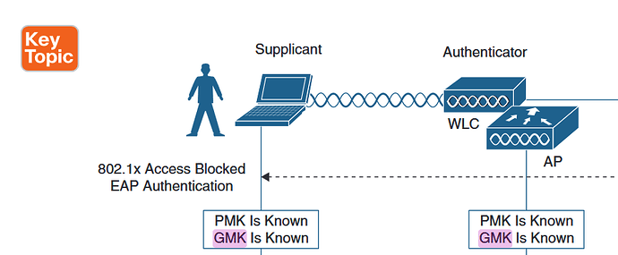

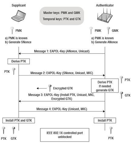

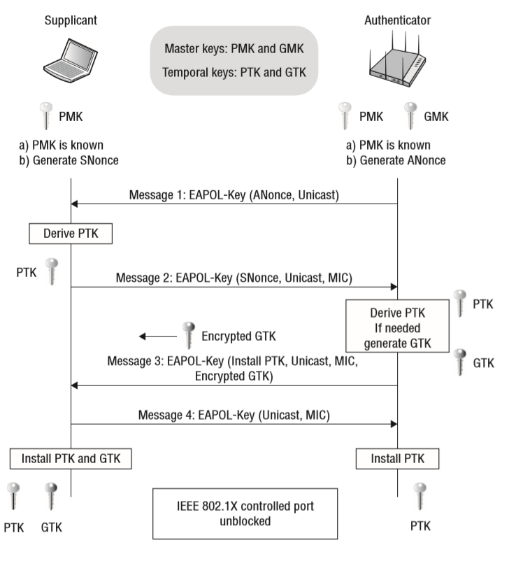

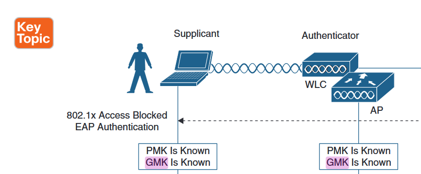

This leads to another thing that confuses me. If the AP/WLC does generate the GMK, does it actually send it to the client or not? My book says that both devices know the PMK and the GMK.
I thought the AP would create a GMK, derive the GTK, and send it to the client for installation. It doesn’t make sense to me for the client to know what the GMK is. This second image says the opposite
