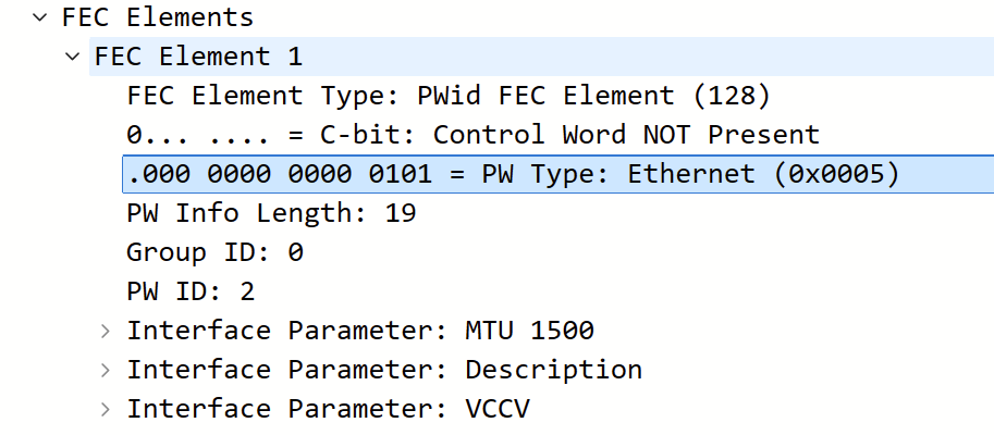

If I understand this correct, when the virtual wire is being signalled between the two PEs, the following order of operation takes place
  1. A targetted LDP session must be built (I know that BGP can be used as well but I think that’s only for VPLS which I haven’t covered yet)
  2. The VC labels are exchanged over this targetted session along with other pseudowire information and the pseudowire goes into the up/up state after all is done and verified
In order for the above to happen, the following must be true:
  1. The interfaces that serve as the AC for the customers must be in an up/up state
  2. The interfaces that serve as the AC for the customers must share the same MTU
  3. The xconnect pw-ID must be the same on both routers
Do I understand the signalling process correctly here?
My question is, the PW-ID FEC TLV carries this parameter:
My question is, why is Ethernet considered the “PW Type”? Pseudowire is the virtual circuit between the two PEs. It’s the AC where the customer is connected that is using Ethernet, or not?
Thank you!!
Your signaling process understanding is spot-on. One subtle but important point is that the PE will advertise the PW label as soon as the xconnect is configured and enabled, regardless of whether the AC is up. However, the AC status is communicated over the same T-LDP session, and if the AC is down, the PE signals this via Label Withdraw or the PW Status TLV, forcing the PW operational state down. So in practice, the AC must be up for the PW to reach up/up.
Your three prerequisites are also correct and all required, so it looks like you have a solid grasp on these aspects. Now, to your question about the “PW Type” field. This is where the terminology itself can be genuinely confusing.
The key point is that PW Type doesn’t describe the pseudowire’s own transport mechanism. It describes the Layer‑2 service being emulated end‑to‑end across the PW. The pseudowire itself is always just an MPLS LSP carrying a VC label, and it has no Layer‑2 “type” of its own. The PW Type field identifies what kind of frames (Ethernet, Frame Relay, ATM, PPP, TDM, etc.) are being encapsulated and carried inside that pseudowire.
The emulated service type must always match the AC technology at both PE routers, because that’s the whole purpose of AToM/PWE3: to transparently extend the AC’s Layer‑2 service from one CE to the other. So “PW Type = Ethernet” doesn’t mean “the pseudowire is Ethernet in isolation.” It means “this PW is emulating an Ethernet service, so both attached circuits are (and must be) Ethernet.”
