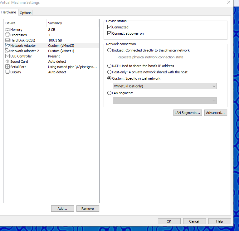

GNS3 version 2.2.48.1
Kali version: Kali-Linux version 2024.2 VMware AMD 64
Router: IOSV
Switch: IOSVL2
OS: Windows 11
VMware version: 17.5 pro
Lab source: https://networklessons.com/cisco/ccna-200-301/arp-poisoning

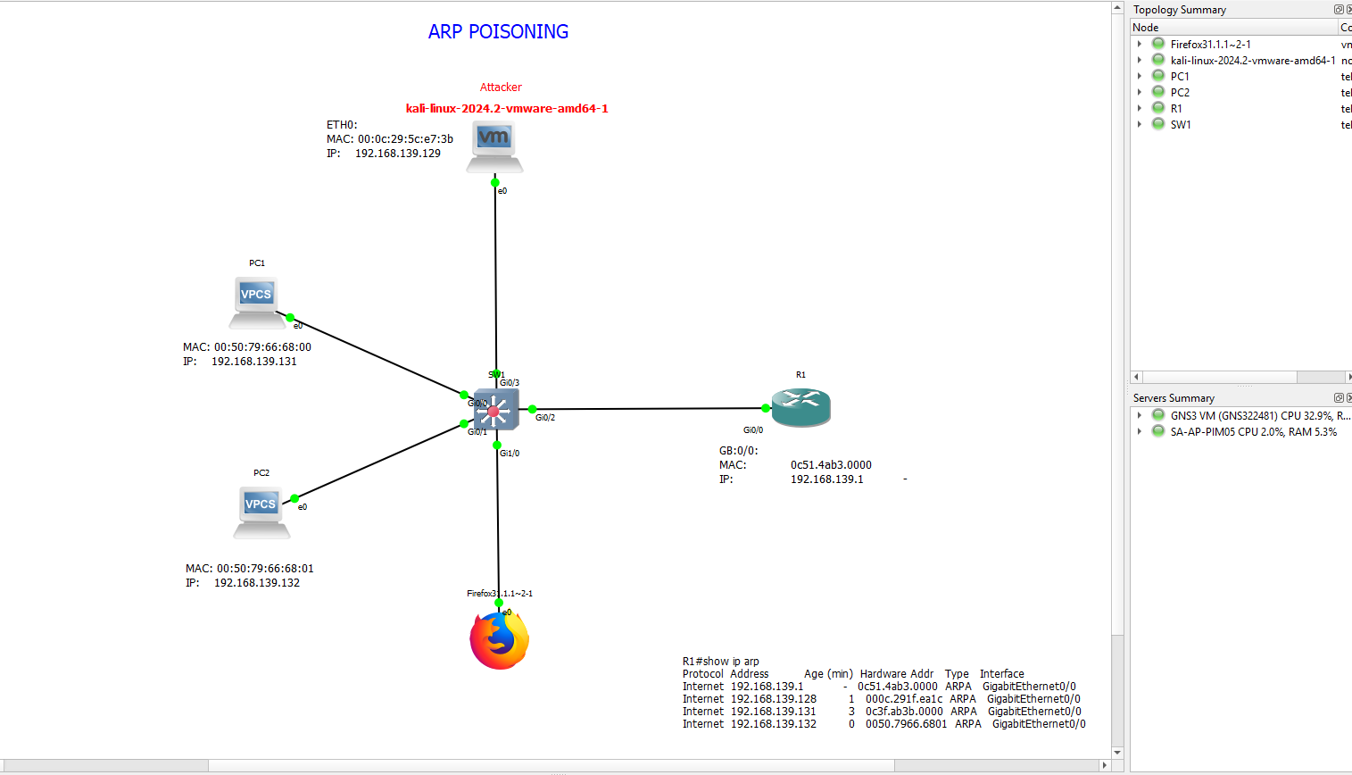

Lab topology:
Steps:

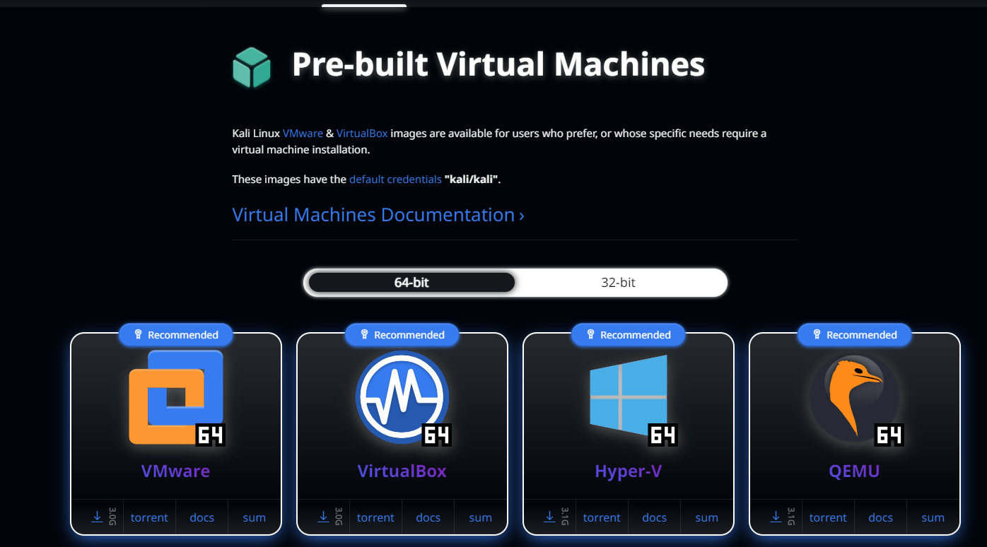

1. Download Kali-Linux-24-2-Vmware AMD 64
  1. Extract package and open the package in VMware

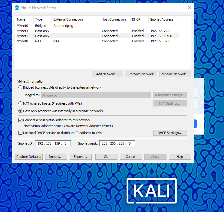

  2. Start GNS3
  3. Import Kali-Linux via menu Edit-Preferences- New → vmware-new (template)

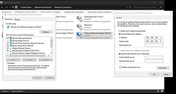

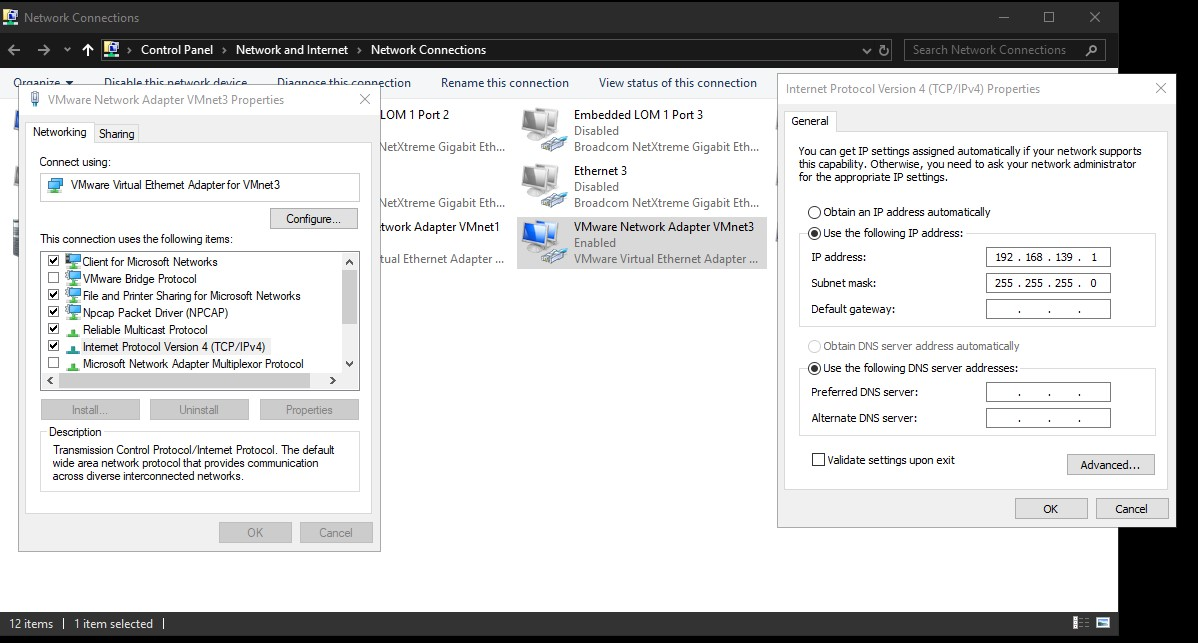

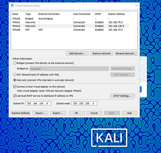

  4. Open Virtual network Editor in Vmware, select Change Settings
  5. Choose Add Network host-only VMnet 3
  1. Open DHCP Settings and make a note of the Scope
  2. Verify if the VMnet 3 adapter is installed in windows 11 (network adapter)

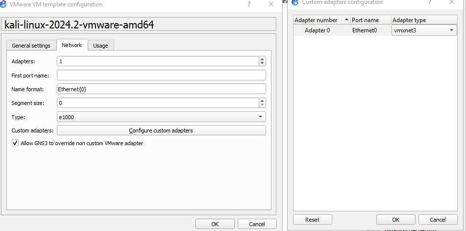

  1. Go to Vmware and Select tab kali-linux-2024-2-vmware in the Vmware console
  2. Choose Edit virtual machine setting and add a new network adapter
  1. Select Custom: Specif virtual network en select VMnet3 (host-only) in de dropdown list
  2. Pull the Kali-Linux template into the GNS3 console and select from the drop-down menu ‘configure’, select tab network and custom adapter
  3. Select Vmxnet3 from the drop-down list.
  4. Check Allow GNS3 to override
  1. Save all settings and reboot windows 11.
  2. Restart GNS3 and complete the topology
  3. Start the lab and complete the configurations (R1 fixed IP address G 0/0)
  4. Select Kali in VMware environment
  5. Log in Kali/Kali
  6. Update Kali via Terminal shell (sudo apt update –y , sudo apt upgrade –y). If you skip the update Ettercap will not function.
  7. In Terminal add network-tools with the command sudo apt install network-tools
  8. Type ifconfig and select interface with ip scope address of VMNET3. Make a note of the MAC address

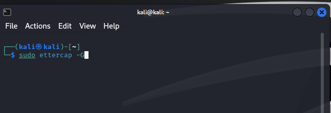

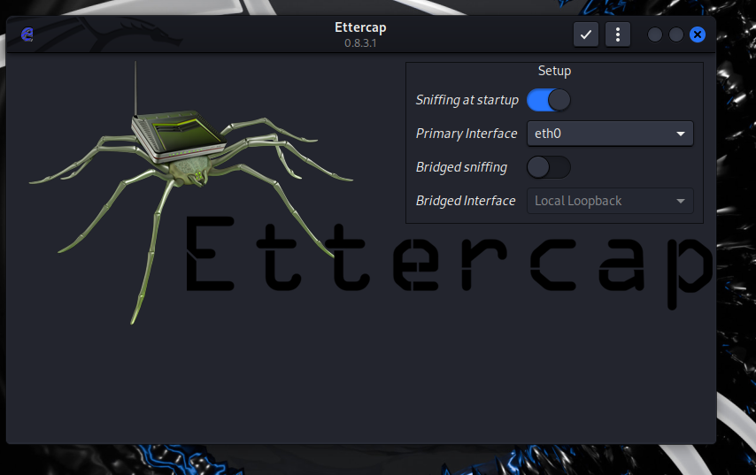

  9. Start Ettercap Graphical from the terminal as sudo (view is different from network lessons)
  1. Select ETH0
  2. Put your mouse on the tree dots right up
  1. Enter the subnet mask 255.255.255.0
  2. Do not select the option Bridged sniffing.

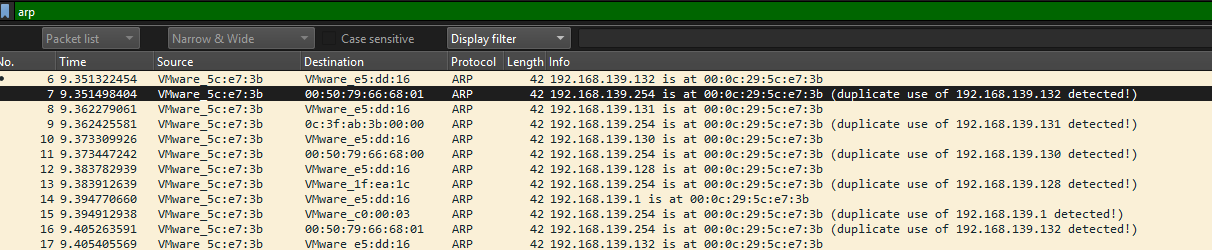

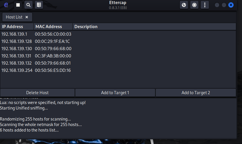

  3. Start Wireshark in Kali and select capture on ETH interface and start the capture
  4. Click on the checkbox and Ettercap starts with unified sniffing.

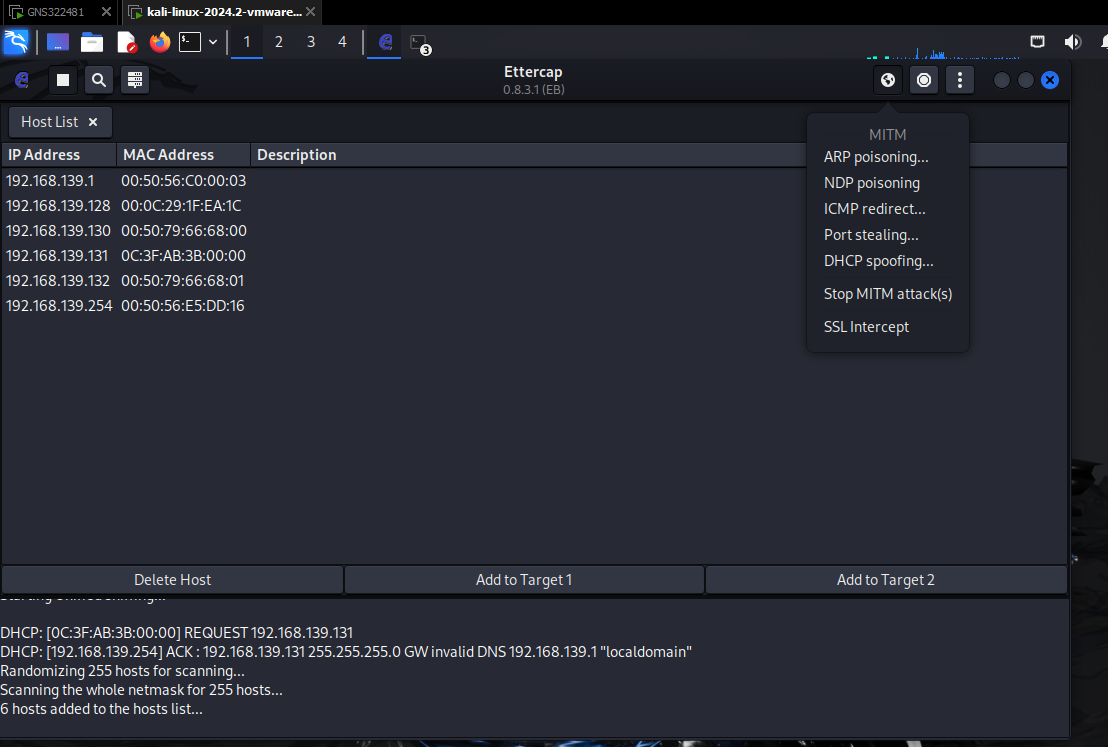

  1. Click on scan for hosts
  1. Select ARP Poisoning
After the poisoning all MAC address have been changed to the MAC address of the Kali Machine.
