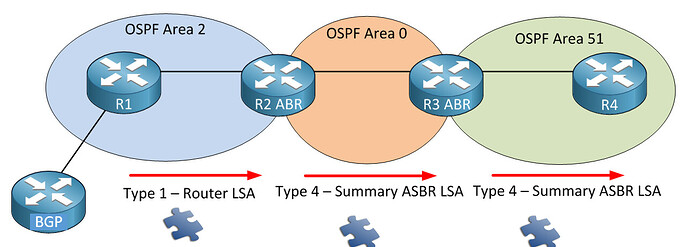

So in a scenario like this one…
R1 is a BGP router and will peer with the router labeled BGP. That makes R1 itself a BGP peer! So the ASBR acts as the point of redistribution between the two routing protocols. Does that make sense?
