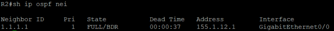

I created the following lab:
1.1.1.0/24—(R1)—OSPF—(R2)—iBGP----(R3)----1.1.1.0/24
Redistribution was used for 1.1.1.0/24 on R2 and the network command on R3. On R2, weight was modified to be the same, LocalPref of 100 remained the same. BGP selected the locally redistributed route over the one learned via the network command on R3, as expected.
However, the next hop was not 0.0.0.0 and is set the the IGP’s (OSPF) next hop. It seems next hop is only 0.0.0.0 if it is a directly connected route.

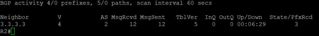

Redistribution is occurring on R2 (see below). There is only OSPF on R1, OSPF and BGP on R2, and only BGP on R3. R2 and R3 are in BPG AS 2.
R2:
router bgp 2
bgp log-neighbor-changes
redistribute ospf 1
neighbor 3.3.3.3 remote-as 2
neighbor 3.3.3.3 ebgp-multihop 2
neighbor 3.3.3.3 update-source Loopback0
neighbor 3.3.3.3 route-map WEIGHT in
The reason I chose to redistribute on R2 and use the network command on R3 was to be certain that it was using the locally originated tie-breaker and not one further down the priority list, such as origin, which it isn’t because igp > egp > ?.
Apologies, I should have been clearer.
Btw, I just tried using the network command on R2 instead of redistributing, and the next hop is still retained (and the origin code is now i instead of ?).

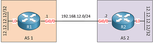

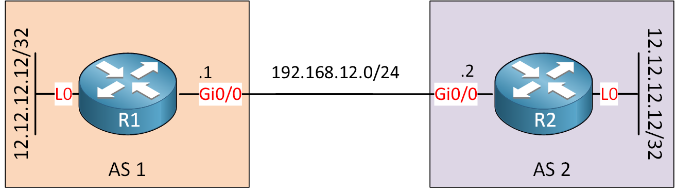

Hi all, :slight_smile:
I am a bit confused about this attribute.
Referencing to the topology from the lesson where both R1 and R2 propagate their L0 interface to each other via eBGP:
R1#sh ip bgp | beg Net
 *    12.12.12.12/32   192.168.12.2             0         32768 2 i
 *>                    0.0.0.0                  0         32768 i
R2#sh ip bgp | beg Net
 *>   12.12.12.12/32   0.0.0.0                  0         32768 i
 *                     192.168.12.1             0         32768 1 i
According to the path selection process, the locally originated prefix would be prioritized and selected as the best route. However, it will never be visible in the RIB since the AD of eBGP is worse than directly connected routes. In other words, if the prefix with the local next hop on either side is removed from the BGP table, it will always end in a RIB failure on the other side.
So my question is, in which scenario would this attribute have a real effect?
Hello Marcel
Indeed, the network is directly connected, and the AD would cause the connected route to be chosen over any eBGP-learned route in the local routing table. This would be the case for any locally originated route that comes from a directly connected route.
Remember, the point of BGP is not necessarily to install a route in the local routing table. The fact that the route has entered the BGP table means that this router is now advertising this route via BGP. So in most cases, when you have a locally originated route from a directly connected network, the purpose is to advertise it via BGP, not necessarily to install it in the local routing table. Does that make sense?
