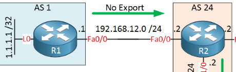

In the lesson, a route map is used to set the community of particular prefixes to no-export. That route map is always applied to a neighbor using a command similar to this, as seen in the lesson:
R1(config)#router bgp 1
R1(config-router)#neighbor 192.168.12.2 route-map NO_EXPORT out
At the end of the command, either the in or out keywords can be used. What do they signify? They define in what direction prefixes should be modified. So looking at this particular portion of the topology:
The route map is applied on R1 in an outbound direction. This means that all prefixes within BGP updates sent from R1 to R2 will first have the route map applied to them before going out of the Fa0/0 interface. Any prefixes received from R2 will not have the route map applied since those updates are moving in an inbound direction.
Remember, the in and out keywords don’t refer to the direction of actual user traffic, but the direction of the updates passing from one BGP peer to the next. Take a look at these two NetworkLessons notes for more info on how route maps and their applied direction affect how BGP operates:
