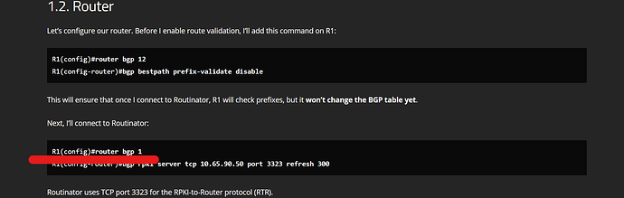

Hello Dears,
Usually when it comes to RPKI, we just check the online tools such as Routinator as you mentioned to check if the route is valid or not,
Now could you please explain why we need to configure it up in the routers? does it going to help and not advertise those routes when is not valid or not found to the peer routers?
also this shouldn’t be router bgp 12 or it is okay ?
And please why prefix 44.44.44.44/32 is not found route?

As for the typo in the lesson, you are correct, that should indeed be bgp 12. I’ll let Rene know to make the change.
