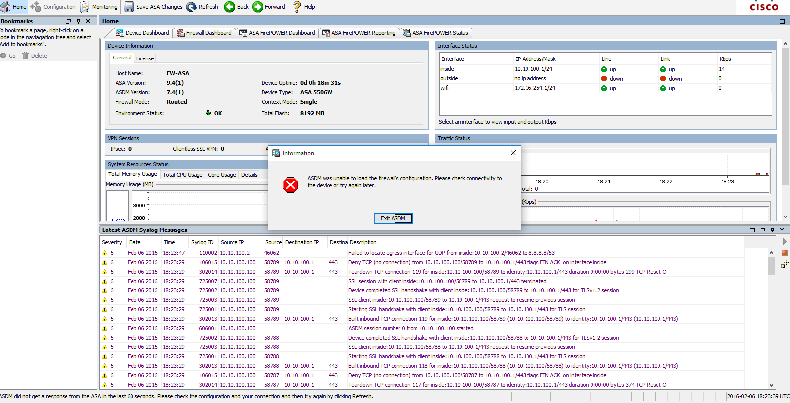

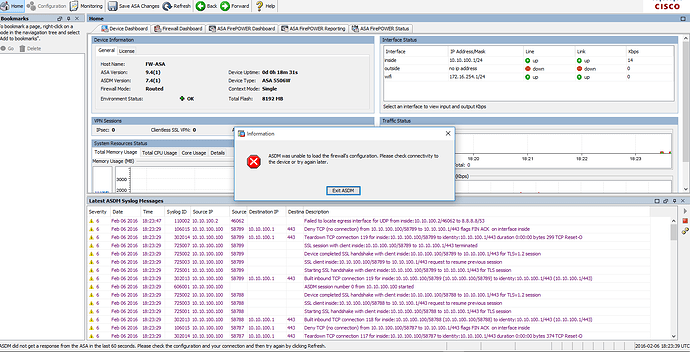

Hi I am getting the Firepower up but then i get this message
Hi Oskar,
I had the same issue…are you using Windows 10?
Once I switched back to windows 7 + latest version of ASDM this problem would go away.
