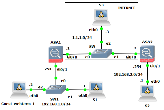

i lab this lesson in GNS3 like this
S1,S2, S3 are build with GNS3 appliance Networkers’s toolkit
Guest-webterm is a linux GUI client with firefox, build with the GNS3 appliance Webterm
My lab works fine, but i want to add these comments and questions
