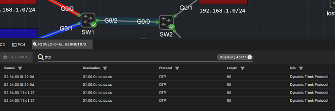

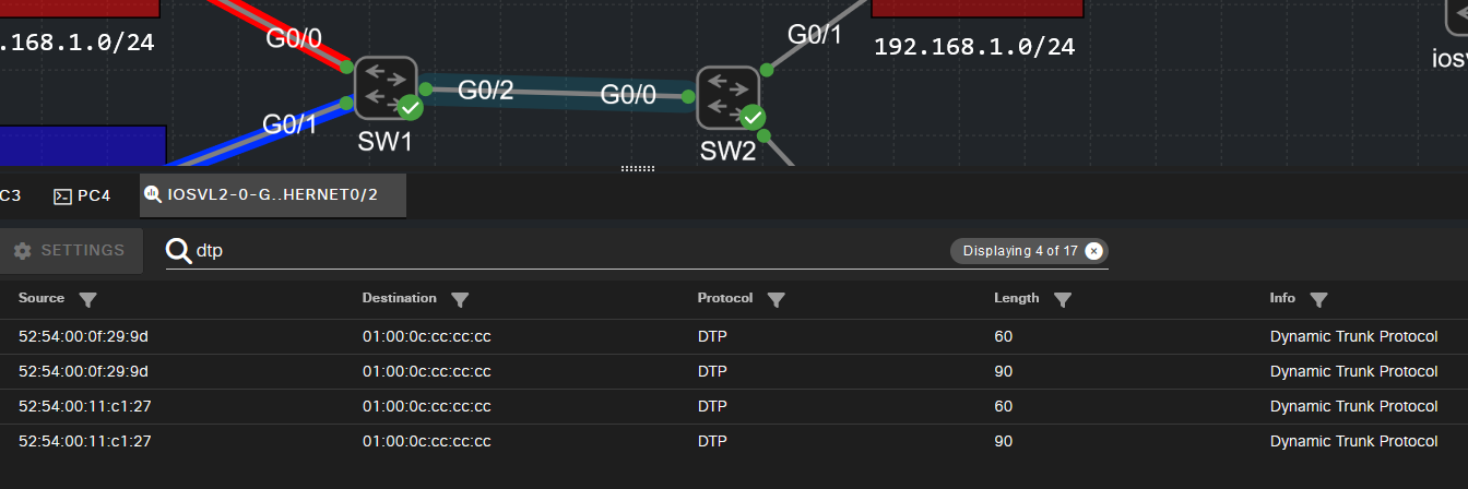

I thought that the switchport mode dynamic auto option tells DTP to passively wait for a negotiation message from the switch the interface is connected to and to not attempt any negotiation unless a message is received from the other side.
However, in my CML lab, despite my switches being configured for dynamic auto, they’re sending DTP messages.
obrázok
obrázok

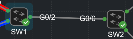

Note that they’re not forming a trunk but why are they sending DTP messages? They’re configured for dynamic auto, not dynamic desirable.
Even though a Cisco switch port configured with switchport mode dynamic auto is passive in terms of initiating a trunk negotiation, it still sends out DTP frames. This behavior is part of the DTP’s design. If you take a look at the capture, you’ll see that the DTP messages being sent tell the other end of the mode the local switch is set to. It includes information on the administrative and operational mode of the local port. This information simply tells the switchport at the other end that “I am DTP enabled, and this is my status.” That specific DTP message won’t actually change anything on the other end, since the DTP configuration operates passively, but it is informational in nature.

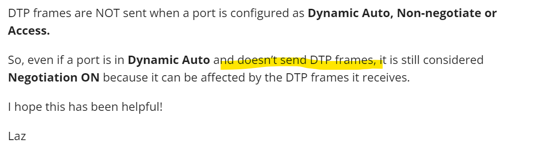

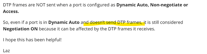

if thats the case, the statements in the snippet is not the correct, right ?
Hello Sathish
Yes, you are correct, my post from 2017 is actually incorrect. I have made the corrections to the post however.
