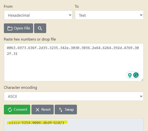

Indeed the output of the show ip dhcp binding command seems to show non-standard output for the client ID compared to what you see within the wireshark capture. I went into the lab and recreated your results as well. The value actually looks like hex, so what I did was I put my hex output into a hex-to-ascii translator, and I get this:
So the output is simply a hexadecimal format of the expected Client ID value.
