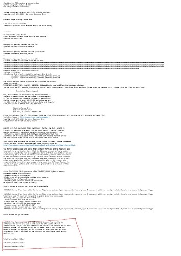

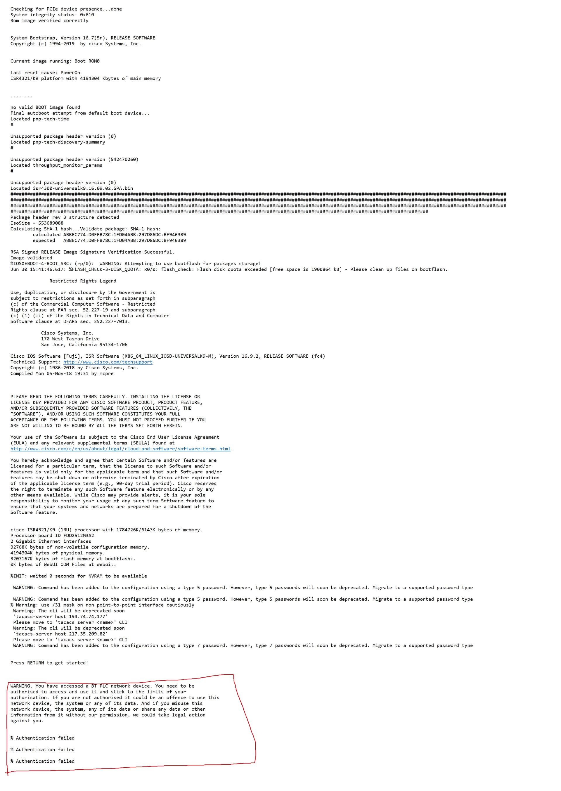

I Bought a router cisco 4321 from ebay for 35 Pounds but there is one issue with it , Its Locked up properly and my knowledge does not let me brake it into it, below I attached booting screen , if there is not an option to break it thru its fine ,psu cost more than all together I get it another one not big deal , sorry for picture but I recommend you to open it in separated window .
Thanks for Help.
Hello Maciej
It looks like you purchased a device that was used on a production network, and they didn’t even bother to clear the configuration!! If the device truly belonged to British Telecom (BT PLC), then it is greatly negligent of them to keep their config intact. Best practice dictates that you should always erase all configurations before reselling such devices to prevent potential malicious users from discovering passwords, IP addresses, and other confidential company information.
In any case, if you want to recover the device, you simply need to perform the password recovery procedure shown in this lesson:
