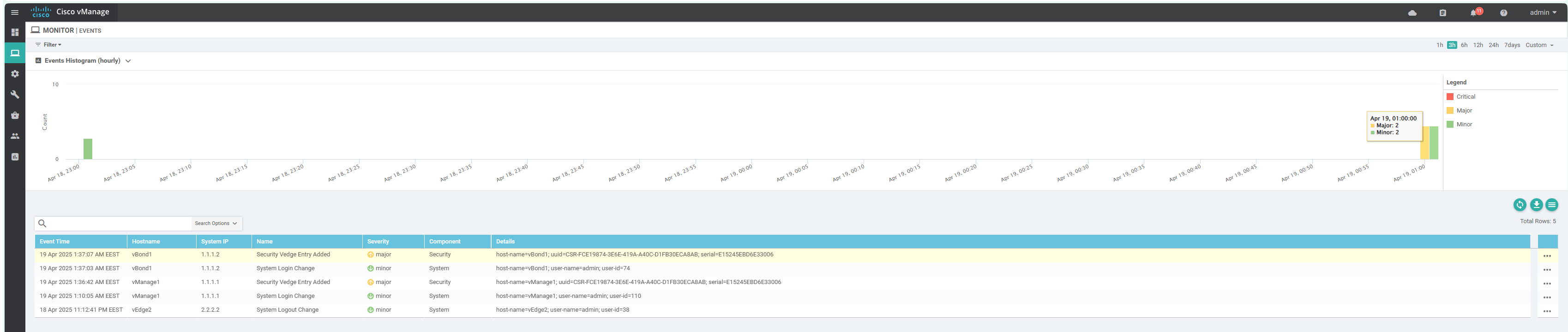

Screenshot 2025-04-19 014956
vManage and vBond has added serials and chassis numbers , but cEdge does not appear on WAN Edge List. No any alarms for bad certificates, or anything to hint me what is the error.
