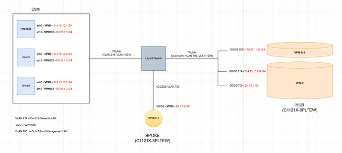

Thanks for the lesson, but I do have a doubt. I am labbing a HUB and Spoke topology on SD-WAN and I am having a hard time on the design. Here is my idea:
I can get the HUB up on the SD-WAN fabric overlay, with all control connections successfully established. But when I get into the SPOKE, I ran into the folloeing issue:
  • The Spoke router can ping 68.1.1.1 (the HUB) and also 214.15.10.254 (G0/0/0.214 on the HUB), but I cannot ping the vBond or non of the control elements from the Spoke.
  • Same applies viceversa, I can ping 68.1.1.1 from the control elements but not 68.1.1.2 (the Spoke). Why?
I configured a default static route pointing to 68.1.1.1 on the Spoke router. I was expecting the simplest routing: the Spoke tries to reach 214.15.10.2 (the vBond) and the packets get to the HUB (which is happening). Then the HUB sees that the destination of the packets is directly connected and proceeds to route them. Why is this not happenning, if both subinterfaces are on the same VPN - VRF?
I appreciate any help, I have stuck with this for many hours. Thanks,
