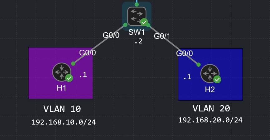

Hello, everyone!
For some reason, the only condition that I could get to actually work was the one related to an interface, none of the others really worked. The IP condition (as mentioned above) doesn’t seem to work, and here is a VLAN Condition that I’ve just created.
However, regardless of whether I issue a ping from H1 or H2, both pings are debugged, even the one coming from VLAN 20.
And neither a MAC address condition seems to work..
Any ideas?
Thank you in advance.
You must keep in mind that whenever you apply a condition, there is a “catch”. The catch is that the conditional debugging based on the criteria you configure, will only apply to those debug commands that are relevant to the criteria you choose.
For example, the conditional debugging based on a MAC address you have configured will only apply to those debug commands that inherently work at Layer 2 or where the MAC address is a relevant piece of information. If you apply a conditional debug with a particular MAC, it cannot be expected to conditionally filter an ICMP debug. It will however apply to a debug of the MAC address table.
Similarly, if you apply a debug condition to VLAN 10, this will only apply to debugs such as spanning tree events that are relevant to VLANs, and not to ICMP messages. Does that make sense?
