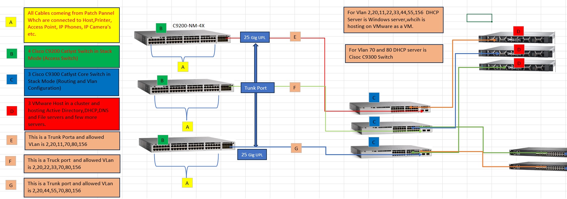

Hello Shrikant
Thanks for sharing your diagram. I’m not sure what your question is, however, it seems that you are wondering about applying DHCP snooping to a trunk port.
You can apply DHCP snooping to a trunk port, and in fact, it’s common to do so in scenarios where you have multiple VLANs and you want to ensure DHCP integrity across them.
DHCP snooping works by filtering and allowing DHCP messages on specific ports, regardless of whether those ports are access or trunk ports. When you enable DHCP snooping on a VLAN, it applies to all ports that are members of that VLAN, including trunk ports that carry the VLAN in question.
If you have a more specific question about your shared topology, let us know!
