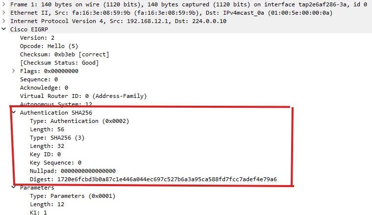

I have few questions:
1). Why we need the authentication like sha or md5
2). Can you help me understanding the wireshark capture cause I couldn’t understand the packet flow.

Hello Speedosuper111
Excellent question! Configuring authentication is one thing, but understanding the “why” is another, and that’s extremely important!
One way that a malicious entity may use to disrupt or compromise a network is to try to establish an unauthorized EIGRP adjacency with one of the routers on the network. For example, I could bring in my own router to work (or run a program on my laptop that simulates a router) and plug it into the network jack in an attempt to create such an adjacency.
If I am successful, I can learn about the routes being advertised by EIGRP, and I can also inject my own routes into the routing domain. At the very least, I can disrupt the network, and at worst, I can inspect traffic traversing my “router” possibly compromising user data as well.
Authentication ensures that only authorized EIGRP peers will create adjacencies. Unless I have the password, I will not be able to create an adjacency from my rogue router to a legitimate EIGRP router, and that adds saftey and security to the network.
When authentication is enabled, each hello and update message is sent with the Authentication SHA256 section which contains a hash digest in the packet as shown:
The receiving router will verify that digest by running the hash on its own copy of the same key-string or password. The adjacency will form only if those match.
All subsequent messages (Hello and Updates) will contain that digest. (It will be different for each packet containing the messages, because the hash is applied to all the contents of the EIGRP message). The verification is performed for each received message, and only then will the messages be processed. This is the case for both the password configuration and the keychain configuration options.

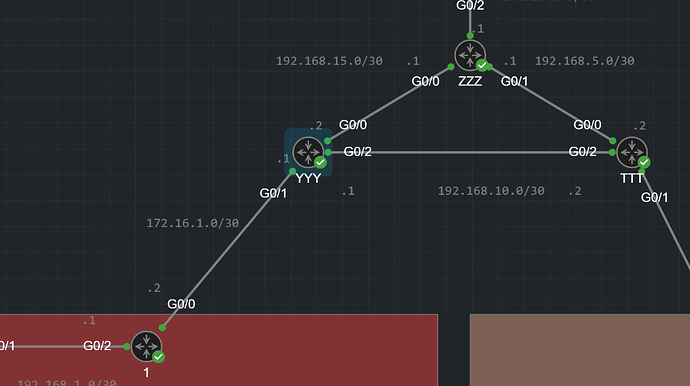

I am trying to lab a few scenarios on CML using the contents of the lesson, and I am running into an issue that I wanted to ask about.
I have the topology pictured below, and I am trying to use different methods of authentication for the neighbor adjacency between YYY and edge router 1 on the red site, and YYY and the TTT router.
I configured named mode on YYY and TTT since I wanted to authenticate their neighbor adjacency using SHA. My configuration on these routers is as follows:

My authentication between 1 and YYY works fine, and the neighbor adjacency is running:
YYY#sh ip eigrp nei
EIGRP-IPv4 VR(YYY) Address-Family Neighbors for AS(20)
H   Address                 Interface              Hold Uptime   SRTT   RTO  Q  Seq
(sec)         (ms)       Cnt Num
1   192.168.10.2            Gi0/2                    14 00:01:01    1  5000  1  0
2   172.16.1.2              Gi0/1                    13 00:26:17  662  3972  0  29
0   192.168.15.1            Gi0/0                    12 00:36:12   12   100  0  63
For some reason the adjacency between TTT and YYY will not come up, it shows its there on YYY but it doesnt appear on TTT. On YYY I keep getting a syslog notification that the adjacency on g0/2 is down because of the retry limit exceeded.
Is there anything else that I need to configure in order to apply different authentication parameters on multiple interfaces of the routers?

Hello Paul
Great work taking the initiative to lab different authentication scenarios! This is exactly the kind of hands-on practice that builds deep understanding. I can see you’ve put thought into your configuration, and you’re very close to the solution.
Glancing over your configs, I do see something that could potentially be a problem, but you’ll have to try it out to confirm.
On YYY, you’re applying authentication key-chain SITES on both interfaces, and that key-chain contains two valid keys:
  • key 1 = “SITE1PASSWORD”
  • key 2 = “TTTNEIGHBOR”
When a key-chain has multiple valid keys, IOS will use the lowest-numbered valid key to SEND (unless you’ve explicitly constrained which key is used). So on Gi0/2, YYY is very likely sending using key 1 (SITE1PASSWORD).
On TTT, your key-chain has only: key 2 = “TTTNEIGHBOR”
So TTT will drop YYY’s packets because they’re authenticated with a different key, so the adjacency never fully forms, and you get the “retry limit exceeded” behavior.
Also: the authentication mode hmac-sha-256 TTTNEIGHBOR line is suspicious. According to this Cisco command reference, you normally don’t “select a key” by text name there. That string is typically not used when a key-chain is configured. The key selection comes from the key-chain keys (IDs/lifetimes), not from naming the password.
These are just some thoughts that may point you in the right direction. Let us know how you get along, and if we can be of any further help!
