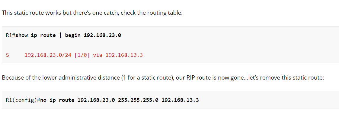

Hi, Rene,
I got a few understandings based on reading this article,
Why there’s only one catch ? That’s because the value of administrative distance is 1 for a static route, but the RIP route is 120 at the same time.
Its value is much higher than the static value, so the static route will not display on the R1 route route table. But when we increase the value of administrative distance for the static route to 121 (which is higher than 120), so the backup route (R3) will display on the R1 route table, and the RIP route is now gone at the time.
Is my understanding right ?
Hello Heping
If the same destination network is learned by a router from different sources, the AD is used to decide which source should be used to populate the routing table. The source with the lowest AD is chosen. So if you have the 192.168.23.0/24 network learned via RIP and via a static route, the static route has an AD of 1 and RIP an AD of 120. So, the static route will be installed in the routing table. If you change the AD of the static route to 121, then the RIP route has a lower AD, so the RIP route gets installed in the routing table. Does that make sense?
