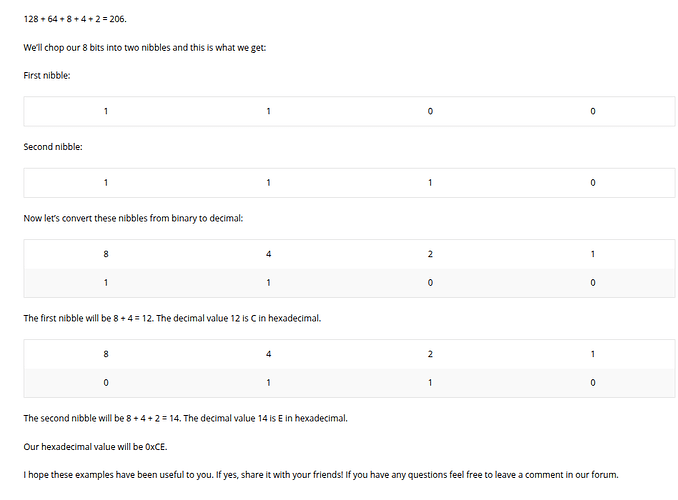

Typo: “The first nibble will be 8 + 4 = 12. The decimal value 7 is C in hexadecimal.”
Thanks Mathijs, it has been fixed.

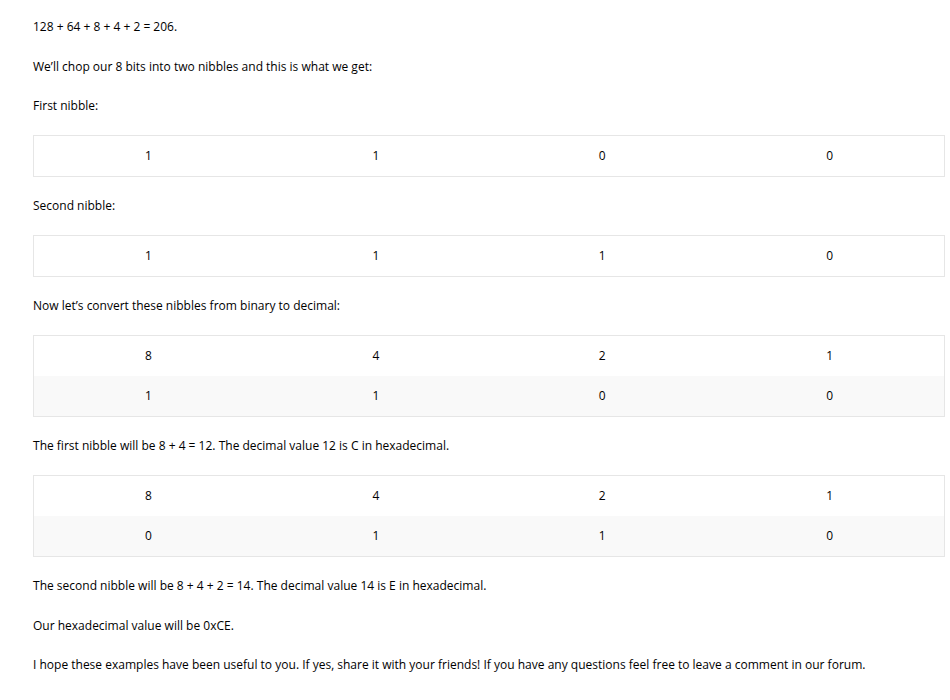

Even though the conversion from decimal to hexadecimal is correct. The image of the last nibble shows a decimal value of 6 not 14. Can this be looked into?
Hello Awais!
Indeed, the last line should read:
The second nibble will be 4 + 2 = 6. The decimal value 6 is 6 in hexadecimal.
Thanks for pointing that out. I will let @ReneMolenaar know to take a look and make the corrections.
