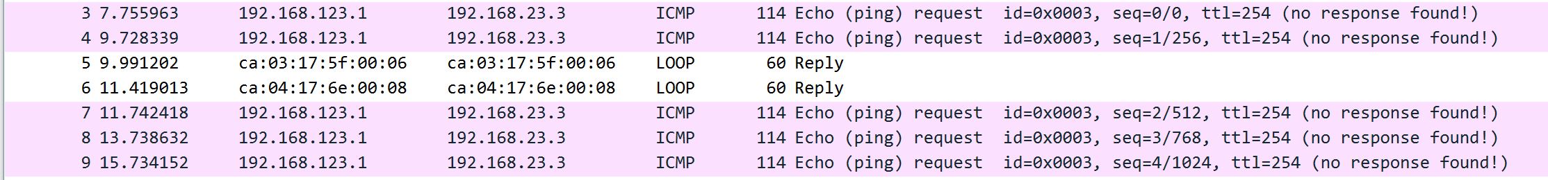

This been tested? How is host 1 which is on the 192.168.12.0/24 network going to reach the 192.168.23.0/24 network since it has no routes there? I can see it being able to reach 192.168.23.2 as its on the NAT router.
However it will not reach 192.168.23.3 which is IP address of Web1
Host1#ping 192.168.23.3
Sending 5, 100-byte ICMP Echos to 192.168.23.3, timeout is 2 seconds:
nor can you telnet to it which makes sense as you cannot ping to it.
Host1#telnet 192.168.23.3 80
Trying 192.168.23.3, 80 …
% Connection timed out; remote host not respondingHost1#
So I think there is something missing from the configs for this to know how to get there be it static routing or a dynamic. I could not get it to work I will double check my GNS3 routers to make sure it does not have something turned off but this lab does not seem to work :x

I had went back to Static NAT and after finding an issue with typo there was able to get lab up and running so about to come back here test some things.
Ok so my guess was correct. To be able to ping the webserver here we have to do “no ip routing” on this device as well same as the host. Then we also have to setup a default gateway. Once you do that you can then ping from hosts to the webserver… which makes sense as the default-gateway is a form of static routing its basically creating a default route to NAT. I could do basically the same thing by adding default routes to host1 and web1 and not add remove routing. Saying that off top of my head without a great deal of thought but it sounds logically.
anyway in order for this lab to work you need to add the following to the web server:
no ip routing
ip default-gateway 192.168.23.2
Now I will test the PAT portion.
Ok good news the Lab does indeed work after those changes.

telnet worked (But only after NAT was correctly setup… before NAT you could only ping)
