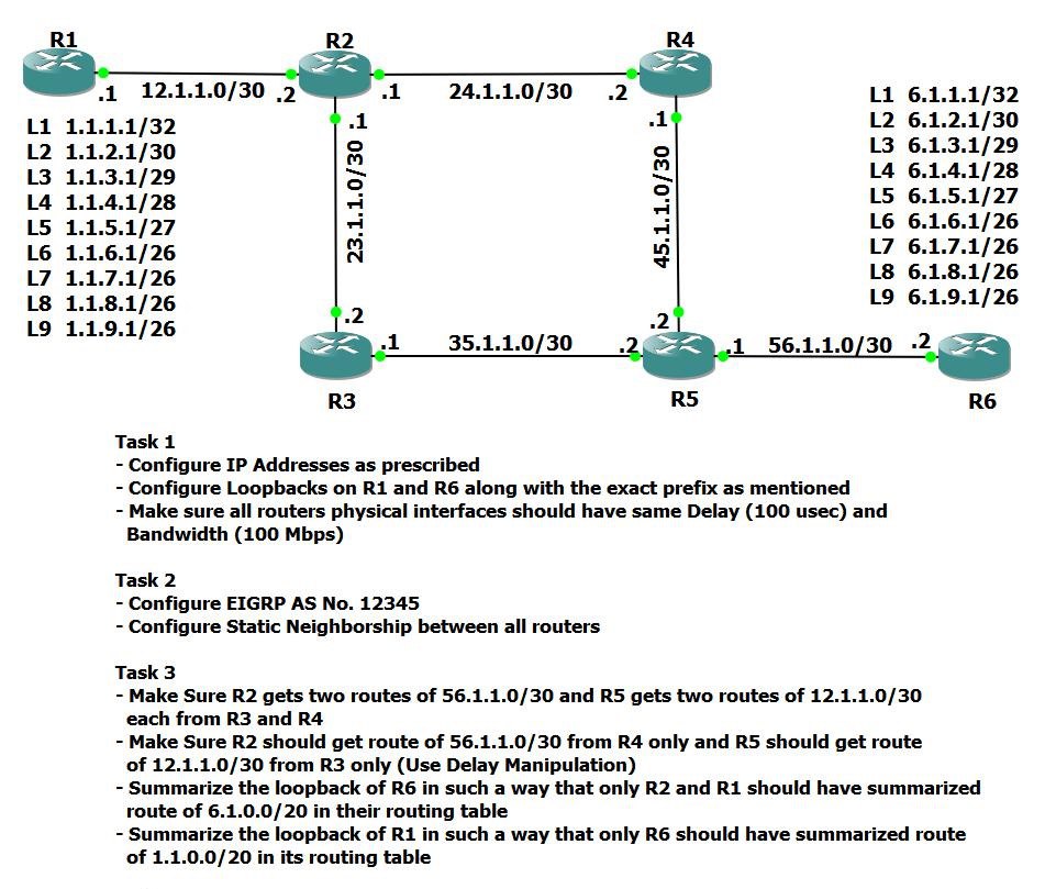

IMG-20251027-WA0002
I have got this topology and I am confused with the last two tasks in task 3 where we have to summarise the routes and we have to make sure only some routers get the summarized route. I didn’t understand that what will happen with the intermediate routers if certain routers getting the routes only.
Hello Speedosuper111
The purpose of the last two tasks has to do with the application of summarization, and especially, learning where you should apply this summarization to achieve the requirements.
In the first one, it asks you to summarize the loopbacks of R6 in such a way that only R2 and R1 should have the summarized route of 6.1.0.0/20 in their routing table.
That means that R2 should only receive a single summarized route and not the individual routes. R2 in turn will then relay that summarized route to R1. So the key question is how do I apply summarization so that R2 will only receive the summary route? The answer is, apply summarization on the interfaces facing R2. Specifically, the interfaces of R3 and R4 that face R2. On both of these interfaces you must apply the following config (assuming Gi0/0 faces R2 in both cases):
interface GigabitEthernet0/0
 ip summary-address eigrp 12345 6.1.0.0 255.255.240.0
The second task asks for something slightly different. Summarize the loopback of R1 in such a way that only R6 should have summarized route of 1.1.0.0/20 in its routing table. That means that summarization should be applied on the interfaces that face R6. Since it’s only R6 we’re concerned about here, there is only one interface facing R6, and that’s the interface on R5. So on that interface, you must apply the following command (again, assuming Gi0/0 is facing R6):
 ip summary-address eigrp 12345 1.1.0.0 255.255.240.0
The intermediate routers will still get the full specific routes, but will only advertise the summary routes at the locations we specified, fulfilling the requirements of the task.

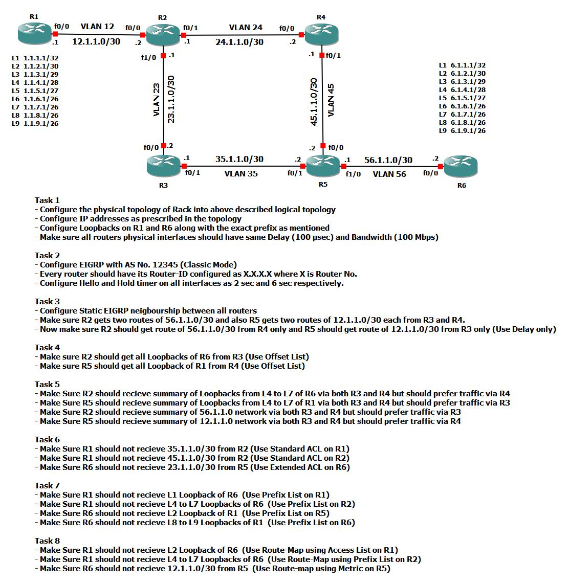

WhatsApp Image 2025-11-05 at 10.20.09_aff85633
I need a solution ASAP. I dont’ know how to solve task 7 because it requires to use prefix list and distribute list on a same inerface which we have already put a access list on task 6 so please help me with task 6 and 7.
Yes, I understand the conflict. Because you’ve already created a distribute list in task 6, you can’t create another one in task 7 because the second distribute list command overwrites the first.
In order to get this to work, you will need to combine the ACL/distribute list in task 6 with the prefix-list/distribute list in task 7 using a route-map that references both filters.
At a high level,
  1. you create the access list as needed for task 6
  2. you then create the prefix lists needed for task 7
  3. Then you create a route map that will
    a) match ip address in the ACL
    b) match ip address in the prefix list
  4. and then, apply the route map to a single distribute list command
That way both will be applied using the same distribute list. Make sense? This should be enough to get you to the right solution. Let us know how you get along!
Yeah, I did exactly that and it worked just fine but I am not certain about how route map permit/deny statements work. I permit in the route map for an access list which first denies the 6.1.4.0/22 network and then permit any and due to this route map didn’t work at all, then I used the permit statement in the access list and deny in the route map and it worked???
When applying a route-map with a distribute-list, you don’t need to focus on using permit or deny statements inside the access list or prefix list itself. Those simply define which prefixes are matched. What’s important is how the route-map interprets those matches. In this context, the route-map acts as a matching mechanism that identifies specific EIGRP updates based on your ACLs or prefix lists. The permit and deny actions within the route-map determine what happens to those matched routes:
  • if the route-map sequence is set to permit, the matched routes are allowed into the routing table
  • if it’s set to deny, the matched routes are filtered out.
  • Routes that don’t match any sequence are implicitly denied, similar to how ACLs work.
So, in your case, when you used a permit statement in the ACL and a deny statement in the route-map, the configuration worked because the ACL defined which prefixes to match, and the route-map told EIGRP to block those specific prefixes from being installed. Essentially, the ACL or prefix list identifies the routes, while the route-map’s permit or deny determines whether those identified routes are allowed or filtered.
