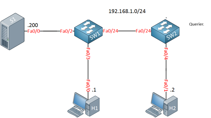

First, let’s look at solution 4 from the lesson. It’s the following commands:
SW1(config)#mac address-table static 0100.5e01.0101 vlan 1 interface FastEthernet 0/3 FastEthernet 0/24
SW2(config)#mac address-table static 0100.5e01.0101 vlan 1 interface FastEthernet 0/4
As the lesson states:
The MAC address that you see above matches destination 239.1.1.1.1. SW1 will forward this traffic on its FastEthernet 0/3 and 0/24 interfaces. SW2 will forward it on its FastEthernet 0/4 interface.
Now these commands on switches SW1 and SW2 operate directly at the Layer 2 forwarding level (i.e. MAC address table). This is kind of a “brute force” method that hardwires the switch to forward any frame with that destination L2 multicast MAC only to the specific interfaces. It’s hardwired and essentially completely bypasses the IGMP snooping process and logic.
Your command with the appropriate MACs and interfaces included is the following:
SW1(config)# ip igmp snooping vlan 1 static mac-address 0100.5e01.0101 interface FastEthernet0/3 FastEthernet0/24
SW2(config)# ip igmp snooping vlan 1 static mac-address 0100.5e01.0101 interface FastEthernet0/4
Now what do these commands do? They create a static entry in the snooping database. Now the next step depends highly on the platform you’re using. I have found that some platforms will actually allow this to work as you expect (Cat 3750/3560 and NX-OS) however other platforms like IOS XE devices still rely on a querier being present to validate the group! Without the querier, the static entry sits in the table, but the ASIC never installs it as a forwarding entry. So you see it in the show ip igmp snooping groups output, but no packets are forwarded. So this command may not work on some no-router topologies because the snooping engine won’t install the entry into hardware unless a querier is present. So the group stays inactive, and no replication occurs. Does that make sense?

Am I right in saying that for Solution 1: IGMP snooping querier, the Querier has to be on the same switch as the multicast source? Because if it was on SW2 then the IGMP report sent by a receiver on SW2 wont be forwarded to SW1 and as a result multicast source traffic wont be sent to receivers on SW2.
Am I understanding that correctly?
Sam
Hello Sam
Actually, this is not the case. You can configure the IGMP snooping querier on any switch in the VLAN, including SW2. Multicast will still work correctly.
In a Layer-2-only VLAN without a multicast router, the switches cannot learn multicast groups by default. The IGMP snooping querier feature solves this by sending periodic IGMP General Queries (224.0.0.1). These queries are flooded across the VLAN.
Whenever a switch receives an IGMP General Query on an interface, it marks that interface as an mrouter port. This simply means, “if there is a multicast router or querier, it is reachable in this direction.”
Because of this, when a switch receives IGMP Reports from hosts, it does not flood them everywhere. Instead, it forwards them only out its mrouter ports. This ensures that any multicast router, or in our case, the snooping querier, can receive the Reports if it needs them. Meanwhile, each switch still learns local group memberships and builds its own multicast forwarding table.
So yes, having the querier on SW2 works perfectly fine, and group membership will be learned throughout the VLAN.
Thanks for responding.
I understand how membership reports forwarded to the querier combined with IGMP snooping keeps track of where listeners are located, including on neighbouring switches. My understanding was how multicast traffic from the source would reach listeners on other switches if it didn’t have a querier on the same switch was what I was confused about, because IGMP snooping would only know about local listeners.
For example, in the diagram below, SW2 is the querier, which means SW1 would only see H1 as a listener on Fa0/3. Whilst SW2 would see H1 on Fa0/24 and H2 on Fa0/4.
However, as you said, SW1 would mark Fa0/24 as an mrouter port and forward traffic from S1 to it, which actually answers my question as to how source traffic makes it to non-local listeners when the querier is not on the same switch. That’s the part I didn’t figure out.
