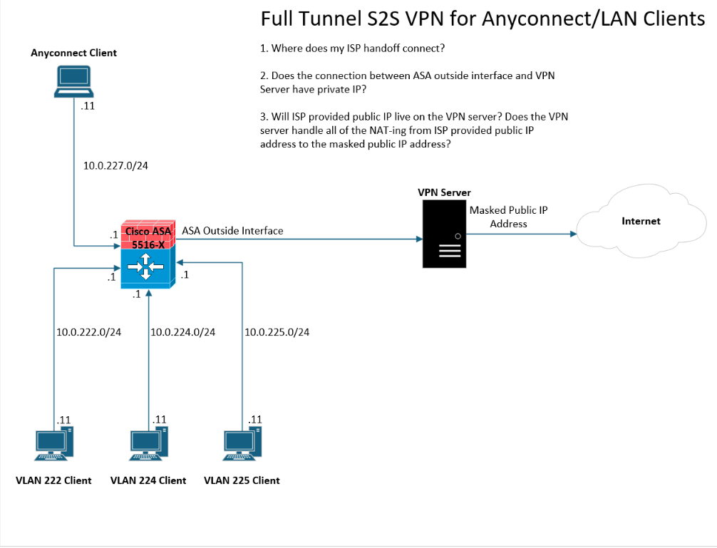

I am trying to Full-tunnel all of my LAN/Anyconnect traffic through a S2S VPN to a VPN Server (considering using StrongSwan on a Linux box). I want to encrypt my internet traffic and mask my public IP address. Based on my drawing and what I am trying to do, is this feasible? Am I thinking about this the right way?

Hello McKay
Thanks for sharing your planned network topology. There are a few questions I have before considering the problem at hand:
  1. You say that it’s a site-to-site VPN. This means that the VPN server and the Cisco ASA are at different sites and are connected over the Internet? Are they connected behind NAT or with public IP addresses?
  2. If “1” is true, then does the VPN server connect to the internet via the same connection it uses to create a site-to-site VPN with the ASA over another Internet connection? This will affect how internet traffic is routed, and how VPN trafffic is routed.
Once these topological questions are cleared up, then we can move on to the more specific VPN configurations. Ultimately, the setup you are attempting to create is indeed doable and is often used in networks where branch office traffic to the Internet is served from the Internet connection of HQ, even if each branch has its own Internet connection. This is often done to enforce policies on internet traffic and for security purposes. Let us know so we can continue the conversation.

As far as exactly where the VPN server is located, I was thinking that it would be physically connected to my ASA’s outside interface. Would a setup like that work? Does the VPN server need to be behind the internet from perspective of the ASA?

A site to site VPN by definition is one where the VPN tunnel itself goes from one site to another, and traverses some sort of unsecured network, such as the Internet. Site to site VPNs are established between devices that terminate the VPN tunnel. I assumed the ASA was one of those devices, and the VPN server the other, that is why I thought the internet would be between those two.
Can you define your sites in your “site to site” topology? That will help to further understand your setup and what you want to achieve. Since you have an anyconnect VPN client, could it be that you are not creating a site to site VPN but a client server VPN? Let us know…

Upon researching this further, it seems that I will need to spend some $$$ to make this work. I would need likely Azure/AWS/Business-level VPN services for my VPN server to operate as I intend.
I am looking to have a S2S connection between my ASA FW (on prem) to a VPN Server, to mask my client internet traffic without needing software installed on all of my individual devices. Unless you know of a cheap/free way to accomplish this, I will probably abandon the enterprise.
