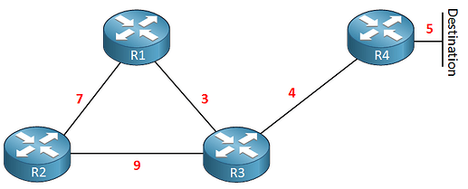

Why doesn’t R1 advertise a distance of 12 to R2? That would allow R1 to have an “advertised distance” of 12 in the table instead of 25. R2 would still choose R3’s path because the advertised distance of 9 would be less than R1’s path.
Hello Roger
From my understanding, you’re referring to this topology here:
Now, when looking at the advertised distances and feasible distances that are calculated and stored by EIGRP, we must always determine the point of view we are looking at. In the lesson, we’re looking at these values from the point of view of R3. So the values in the table show how R3 “sees” the network.
Now you asked:
Well, R1 does indeed send an advertised distance of 12 to R2. But that value will be received by R2 and stored within its own table, making up its view of the network.
But we are looking at the network from the point of view of R3, and how this information makes R3 behave, as far as routing and as far as the feasibility condition go. So this information doesn’t affect what path R2 will choose. If you want to take a look at that info, you must “build” the corresponding table of advertised and feasible distances for R2. Does that make sense?
