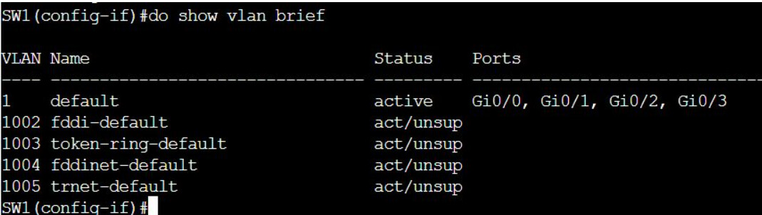

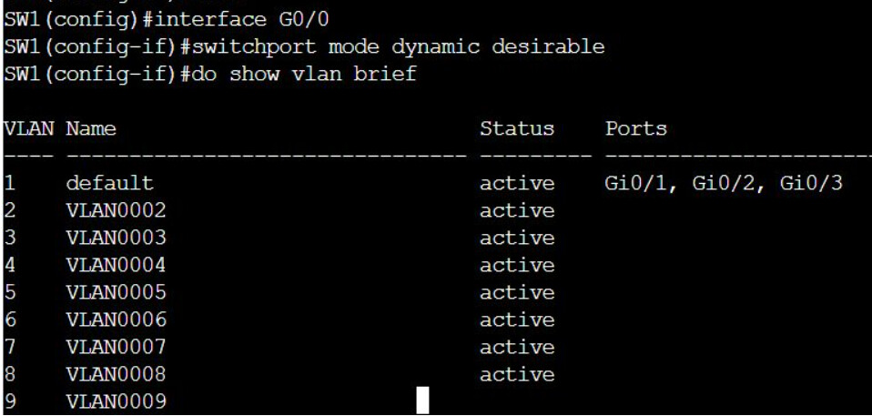

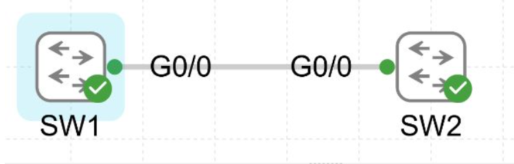

Configuring a trunk link between the switches is necessary for VTP messages to be forwarded over the link. If you do not configure a link as a trunk, VTP advertisements will not be forwarded over it which makes sense because the purpose of VTP is to synchronize the VLAN database. If the link was not a trunk, those synchronized VLANs would never be able to communicate.

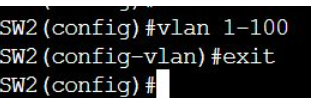

(SW1 and SW2 have been configured for VTP). The link is an access link. Let’s create some VLANs on SW2
obrĂĄzok

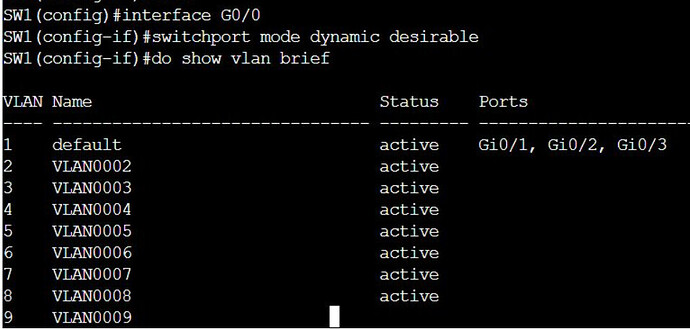

Since the link is not a trunk, VTP advertisements won’t be carried over it and SW1 will not synchronize its database with SW2.
Once we configure the trunk, VTP advertisements will be carried over and it will all work
