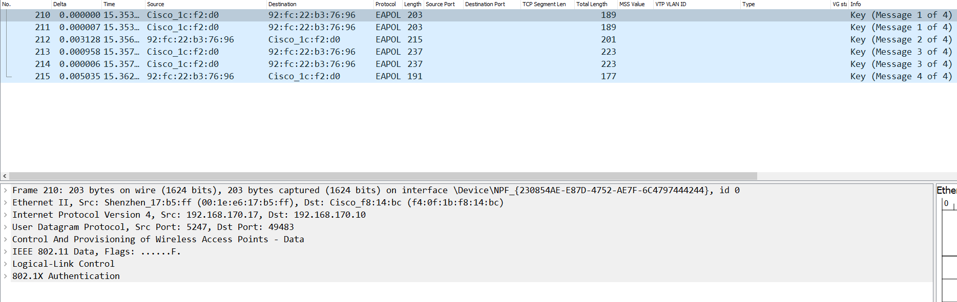

So EAP is used even if we’re not using WPA Enterprise? The 4-way handshake goes like this:
obrázok
It’s using EAPOL to perform the authentication.
It’s just a little confusing considering that it says 802.1x at the bottom even though I am not using that.

But this doesn’t mean that EAPOL isn’t being used, right? So is it right to say that it’s a transport protocol that carries PSK-related information and in the case of WPA Enterprise, EAP messages?
Also, what exactly is the difference between EAP and EAPOL? This part confuses me a little
EAP is always carried by another protocol. To transport EAP messages, we need to encapsulate them. EAPOL (Extensible Authentication Protocol over Local Area Network) encapsulates EAP packets within Ethernet frames.
The messages themselves are a part of a certain protocol such as EAPOL? If so, are there any other protocols that can contain these EAP messages?
EAP authentication itself is not used in WPA-Personal, as this mode relies on a shared password for authentication. However, EAPOL frames are still utilized in the 4-way handshake process for key derivation and mutual authentication, even in WPA-Personal. This explains why you see EAPOL as the protocol of those handshake messages in Wireshark.
The presence of “802.1X” in the Wireshark capture refers to the encapsulation standard (EAPOL), not necessarily 802.1X authentication. EAPOL is part of the 802.1X framework but can be used independently for key management. Wireshark simply interprets it as 802.1X.
EAP is indeed not used, but as you suggest, this doesn’t mean that EAPOL isn’t being used for the protocol of the handshake process.
