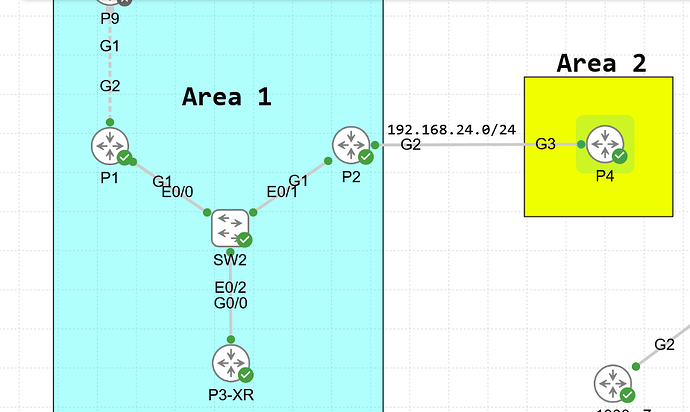

The passwords are mismatched yet P2 is still installing P4’s L2 routes which it shouldn’t…
How is this possible? Is this a bug in CML?
Hmm, that’s interesting. The only thing I can think of is that P2 is still installing P4’s Level-2 routes because IS-IS domain/area authentication does not affect Hellos. On some IOS XE/CML images, received LSPs are not strictly validated unless explicit validation is enforced, so mismatched passwords can still result in accepted L2 LSPs.
This looks more like an image or platform-specific behavior rather than an IS-IS rule. If you want deterministic behavior where a mismatch blocks routing, use interface or Hello authentication or explicit LSP validation (or HMAC/MD5 key-chains). It looks like domain passwords alone are not sufficient to guarantee rejection.

Hello Laz.
I accidentally figured it out and forgot to post, sorry.

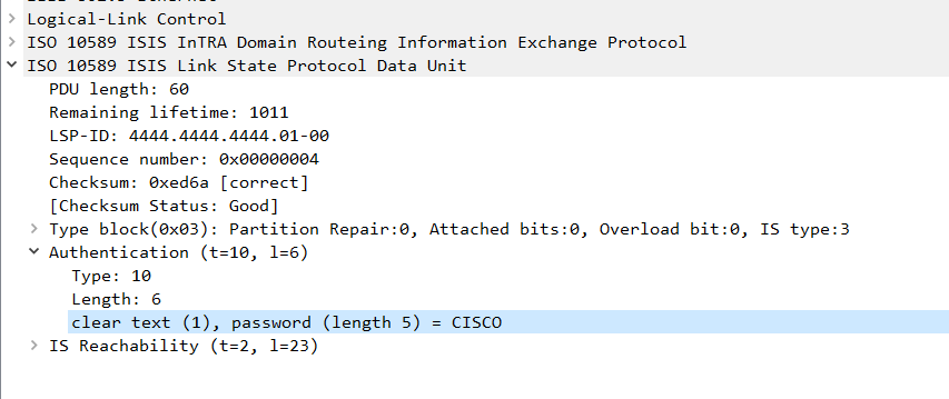

I’ve changed the passwords after the adjacency went UP and the LSPs were exchanged. Which most likely means that the LSPs were still installed in the LSPDB and were waiting to expire, that’s why I also saw those routes since no one really poisoned that LSP, I believe.
Ah I see, thanks for letting us know! This gives us more insight into how IS-IS operates. When you changed the IS-IS authentication password after the adjacency was up and LSPs were already exchanged, the adjacency did indeed drop because the routers could no longer authenticate Hello PDUs . Authentication failures prevent new Hello packets from being accepted.
However, previously received LSPs remained in the LSPDB because they were already validated and installed before the password change. They remain valid based on their aging timers, not on the current adjacency state.
No LSP purges were sent. Even if the neighbor tried, those purge packets would fail. IS-IS purges are just LSPs with remaining lifetime = 0, so if authentication is enabled and mismatched, any incoming LSP (including a purge) will be rejected. For this reason, routes persisted until LSP aging timed out. IS-IS LSPs have a default MaxAge of 1200 seconds or 20 minutes.
Now, the question I like to ask at this point is, why is it designed this way?
IS-IS separates or decouples adjacency maintenance (Hellos) from topology database maintenance (LSPs). Once LSPs are in the database, they persist based on their lifetime timers independent of adjacency state. Remember, IS-IS is built for stability and resiliency. This persistence or “maintaining the status quo” due to this decoupling is thus working as designed.
