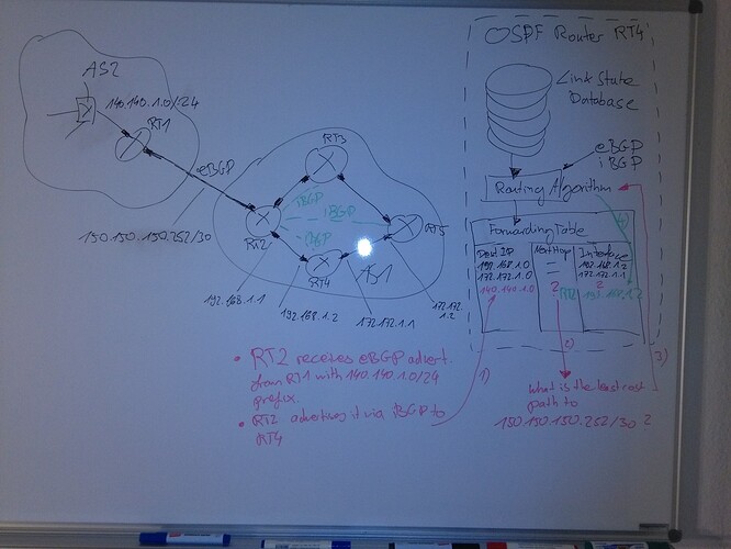

I’ve attached a Photo of a little setup of only two ASs. Is the following chronological sequence right?:
• Router RT1 in AS2 sends reachability information about AS2s subnets via its eBGP session to its Peer RT2 in AS1
• RT2 puts this subnet (140.140.1.0/24) in its forwarding table with the interface on which it receives the advert
• RT2 advertises this subnet to all of its iBGP peers
• RT4 receives RT2s advert and would like to put the new subnet (140.140.1.0/24) into its forwarding table, but it must first determine the best path to get to subnet 150.150.150.0/30
• After running the routing algorithm RT4 can store for example the interface 192.168.1.2 and next hop router RT2 together with new subnet 140.140.1.0 in its forwarding table

Hi Jan,
Your list looks good except for the last step. You might want to check the next hop in RT4’s routing table :slight_smile:
In your topology, there is no need to run iBGP within AS1. You only need iBGP when your AS is a transit AS.
After all, there’s only one exit path in AS1 (RT2) so there is no need for all routers to know specific entries. A default route in OSPF advertised on RT2 could do the job.

Thanks for your quick answer.
Ah ok I think the next hop should be the IP address of RT2s interface 192.168.1.1

Hi Jan,
About the next hop, take a look at “next hop self”. I also included an example what the default next hop is when you advertise something from eBGP to iBGP:
About iBGP…let’s look again at this example:
As a transit AS we have the problem that R3 doesn’t know what to do when it receives a packet with an unknown destination. Instead of iBGP there are a lot of different methods how you could solve it:
  • Redistribute prefixes on R2 from eBGP into OSPF (and vice versa).
  • Redistribute prefixes on R4 from eBGP info OSPF (and vice versa).
  • You could configure a GRE tunnel between R2/R4 and use the IP addresses in the tunnel as the next hops.
Redistribution would allow R3 to learn any external prefix. Using tunneling would ensure that R3 never sees an external prefix.
Once we are looking at full Internet routing tables, it’s another story. A full Internet routing table has close to 600K entries. You can find a lot of discussions how much prefixes OSPF can handle but an entire Internet routing table is a bit too much :slight_smile: That’s why iBGP is a better alternative…
