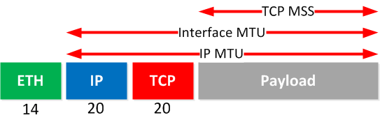

When we talk about MTU, we have to make sure that we’re always using the right context. Sometimes it includes the Ethernet header, sometimes it does not. For example, when you configure the IP MTU or the interface MTU on a Cisco IOS device, it never includes the Ethernet header. This diagram shows this clearly:
Whenever we configure these values, we only take into account the payload. So a “normal” Ethernet frame will have an MTU of 1500, but the extra 14 bytes of the header are assumed.
Now if you have a trunk port, the MTU size still remains 1500, because the extra 4 bytes of the VLAN tag are considered part of the Ethernet header. So you would still have an MTU of 1500, but the interface knows to allow for a header size of 18, so the total frame size will be 1518.
However, if you are using a feature such as QinQ, which adds a second VLAN tag, you must change the MTU of the QinQ switches to at least 1504 to accommodate that additional VLAN tag. Why? Because they don’t detect the internal tag of 4bytes, so they expect a size of 1500+18=1518, but they receive a frame of 1500+18+4 = 1522 so they drop it.
To add confusion to the whole mix, Cisco IOS XR software includes the L2 header in the interface mtu command. So in such a case, you would use the value of 1514 for a “normal” frame on a Cisco IOS XR device, while you would use a value of 1500 on a Cisco IOS device. More info about this is found in the MTU size in Cisco IOS XER and IOS software NetworkLessons note.
In all cases, however, the FCS is never included in the calculation of the MTU. The only time this would be taken into account is if an Ethernet frame is encapsulated within another type of frame (MPLS for example) where the FCS is included in that encapsulation.

Why we use mss adjust?
When another header need to be added, will take place from mss and mss will not pass more than 1360, am i right?
I mean if i have big data, will the mss pass more than 1460 and take from header size? I think no, mss size will still fixed (1360) and headers 40= 1400,
Hello Ali
If you are adding more headers, like when you are using a GRE tunnel or QinQ, then there is no way that you can decrease the MSS directly. Remember when you add headers you are adding them during encapsulation. The MSS is defined at Layer 4 (Transport) so if you are encapsulating in an IP packet, and then a GRE header, and then QinQ where you add four more bits for the second tag, then you are not taking any bytes away from the TCP segment. You are adding more to the whole size of the frame.
The adjust-mss feature allows you to limit the size of the MSS on any TCP session that is traversing that particular interface. If you know what headers are added, you can easily make the adjustments here.
Alternatively, a TCP host can use Path MTU Discovery (PMTUD) to determine the proper MTU to use. More about this can be found at the following Cisco community thread:
PMTUD is not always applicable because some routers in the path may have disabled ICMP responses so PMTUD will fail in such cases.
Keep in mind that TCP hosts are able to adjust their MSS during the initial negotiation of TCP as well as during the TCP session as needed. You can find out more about adjusting the MSS at this NetworkLessons note.

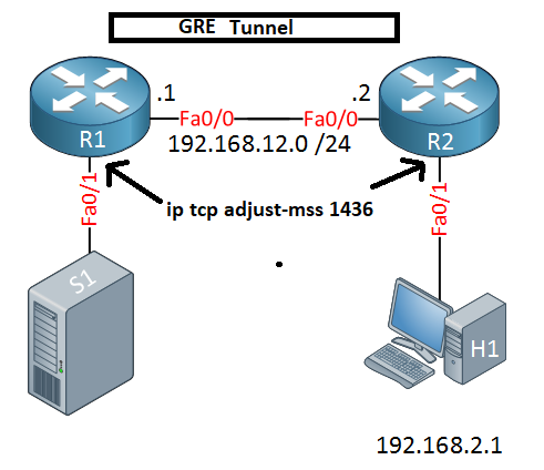

Am I right in saying that if you have two routers connected via a GRE tunnel, using ip tcp adjust-mss command on router interfaces that traffic passes through will mean no fragmentation occurs? i.e. if you set the mss to 1436 (1460 - 24 GRE and new IP header).
For example:
Sam
Hello Samir
This configuration of the ip tcp adjust-mss command will cause the S1 and H1 devices to negotiate a maximum segment size (on the Transport layer) of 1436 bytes for any TCP session they create. Indeed, any TCP session that is negotiated that traverses these interfaces will have their MSS values changed on the TCP SYN packets, resulting in a maximum segment size of 1436.
The maximum MTU size of the GRE tunnel when we take into account the inside IP header of 20 bytes, the GRE header of 4 bytes, and the outside IP header of another 20 bytes (total 44) is 1500-44 = 1456.
However it is also common practice to allow for another 20 bytes of “wiggle room” resulting in the use of 1456-20 = 1436 bytes.
So to answer your question, this means that there will be no fragmentation of the IP packets in such a scenario assuming there are no other mechanisms in place that will create an even smaller MTU for the link between R1 and R2.
