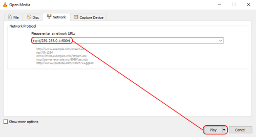

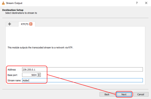

My question is - you have simulated PC by a Router. I want to know how do we configure multicast group in real computer/PC.
C Joshi
Hello Chandrakant.
The multicast group that your computer will join is something that you configure within the application that your computer is running.
For example, the VLC media player application supports multicast and can be used to stream video to the interested receivers.
On the multicast source (the server that is streaming the traffic), you would load the video that you want it to stream and configure which multicast IP address it should stream the video to
On the multicast listeners (the receivers that want to see the video stream), you would just specify the multicast IP address that you want their computers to listen to, and you’re done.
