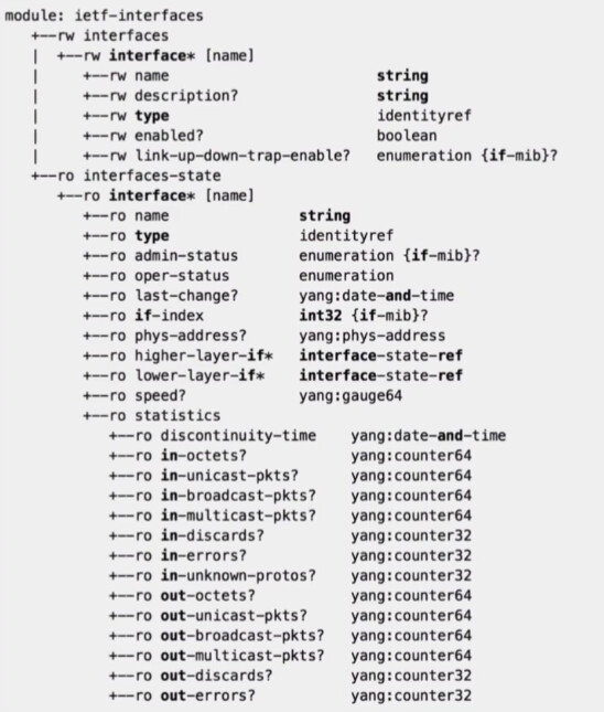

My first question regarding NETCONF is… how do you guys configure it? What are the best practices? I feel it’s quite complex to actually open up and go through all the YANG models and figure out what container to use, what to configure, etc. A lot of resources use ietf-interfaces as example because it’s short and easy to use, but the others aren’t very easy to work with.
What I usually do is I create one loopback as a test and then retrieve the running configuration. I then use the relevant tags to create the other ones.

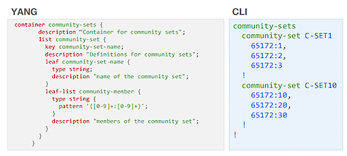

In YANG terms, what exactly is a key? I see that every list has one.
