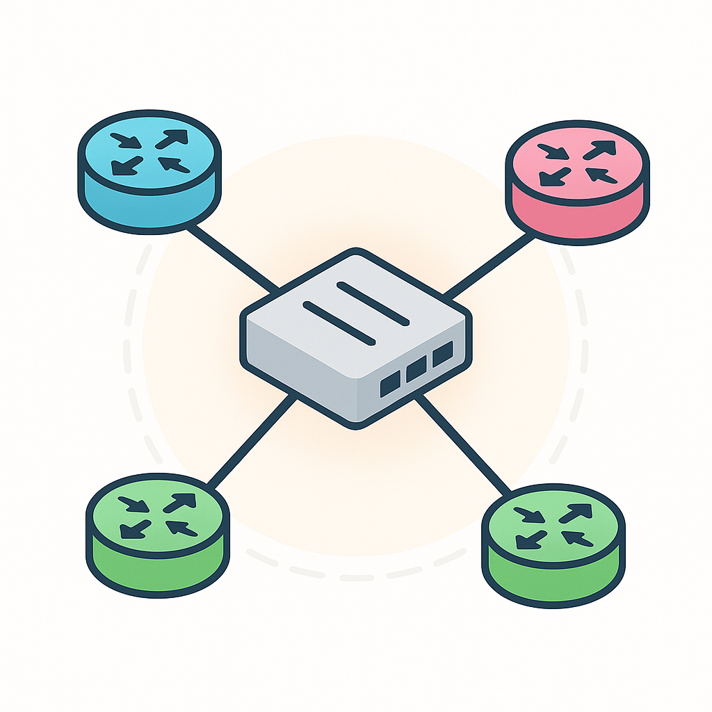

The topology is simply three routers R1, R2 and R3 connected to a switch in a multic-access segment.

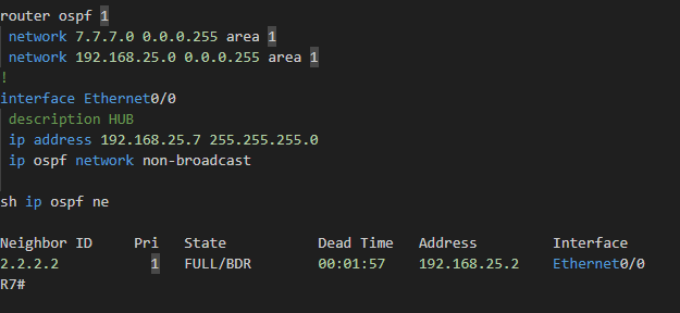

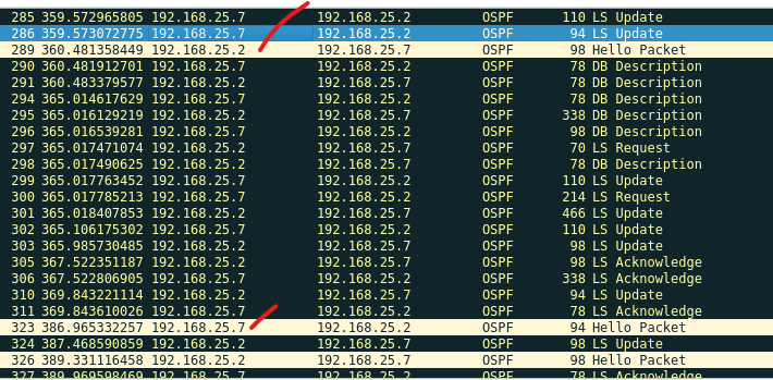

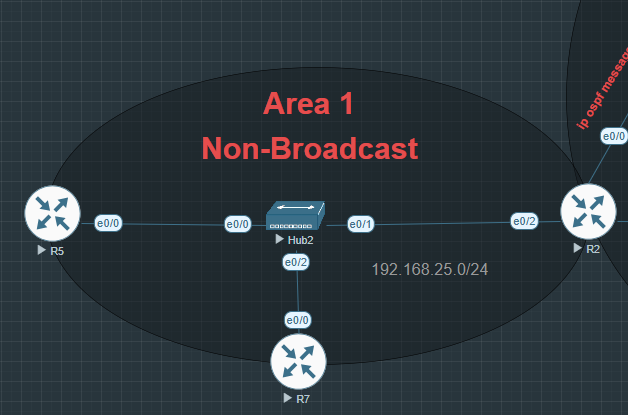

Interesting…
My OSPF neighborship formed when I configured the neighbour statement on only one Router
I just learned that could happen
R7
R2
R7 will respond to R2’s hello and then start sending its own without the neighbor command set on R7
Hello Anthony
Indeed, in an NBMA network, it is possible to establish an OSPF neighbor adjacency by configuring only one end with the neighbor command. When the configured neighbor sends a hello, the unconfigured neighbor is able to determine the adjacency info and respond with its own hello. The neighbor command in such cases is only used to initiate communication, so it is only needed on one end. However, it is best practice to configure it on both ends, so that in the event of a failure, both neighbors are capable of initiating the reestablishment of the adjacency.
