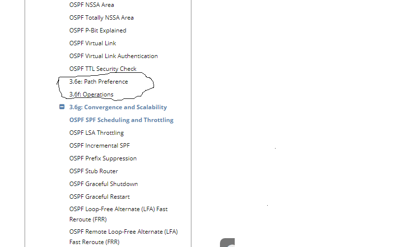

I have one question When i am going through you CCIE R&S Written Table of Contents here why 3.6e:Path Preference & 3.6f:Operations not showing anything when i am trying to click there no page is opening so are you want to add any content there or its mistake by you? then 3.6g:Convergence and Scalability having content because when i clicking the + button the content is coming.
For your reference i attached the screenshot as well.

Hello Arindom
Thanks for that! I have sent out a message to Rene to take a look and fix it!
Hi Arindom,
I just moved a couple of items of 3.6f that should be there but weren’t.
3.6e is empty right now so that is a bit confusing. I’ll have to check which items can go there.
Thanks for replying … if you add any thing there defenately I will go through the point..
